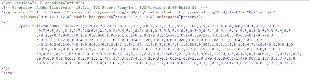

The file accuracy is only one decimal place, now it's not as bad as that might seem as the file's in pixels so 1 pixel is 1/90" or 0.0111 so the file is accurate to about 0.001111" and that's not always going to be good enough.

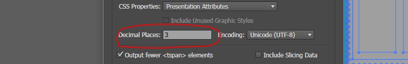

axtn95
That's it!
Easiest method. Just make sure you're good on the AI end, and when you export, choose "3" for Decimal Points
