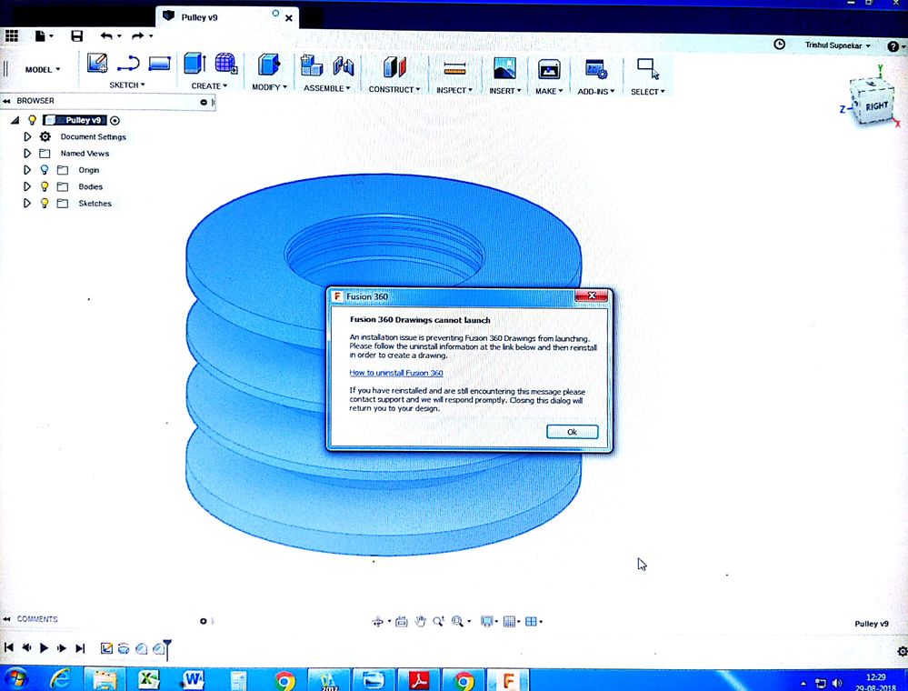

This mail is to inform you regarding Fusion 360 issues, When i am going 3D to 2D for diamensioning(Drafting) my model i am facing the problem below attached image.
Please let me know how to solve this issue ASAP.

Hi @Anonymous,
I am sorry you are experiencing this issue. Can you try the solution described in this thread (post #16) and let me know if it fixes the issue.
https://forums.autodesk.com/t5/fusion-360-support/2d-drawing-not-opening/td-p/8219894

Still its showing same problem please give me the solution regarding 3D to 2D ASAP.

Hi @southernmachine.in,
It sounds like you tried the manual file copy and it didn't work.
Per a later post (#19) here: https://forums.autodesk.com/t5/fusion-360-support/2d-drawing-not-opening/td-p/8219894, this Windows Update should correct the problem: https://support.microsoft.com/en-us/help/4019990/update-for-the-d3dcompiler-47-dll-component-on-wind....
If that does not fix it please let me know.
