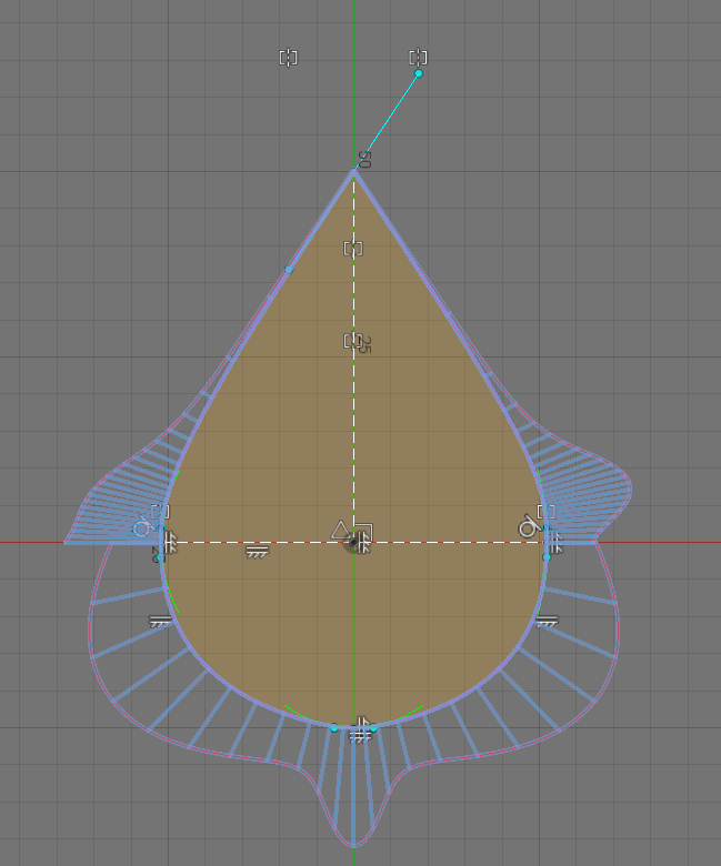

Hey @jeff_strater any idea why the curvature Comb is not symmetrical on the teardrop I've attached to this thread, as far as I can tell I have everything symmetrical.

Hi @HughesTooling, I'm not certain.  It looks like a bug, probably with the solver.  However, when I open that design, my curvature display looks different:
The bottom curve is symmetric, but the top ones are not.
I'll send this to the spline guys to check out.  Thanks for posting it.

Hi Jeff, Part of the reason yours looks different is down to me adjusting the handles trying to make it more smooth. The other reason is I think you added the curvature comb one curve at a time and I selected all 3 and turned the comb on.
Here's an example on the left added one at a time, right comb added to all 3 in one go. I've attached the file with the setup.

Thanks, @HughesTooling for pointing that out about the curvature display.  I had forgotten that this command tries to pick a scale factor for you based on your selection.
As to why they are not symmetric, I'll have to ask the expert.  But, I suspect that it has something to do with a bug that does not allow me to actually make the handle lines themselves symmetric.  In your design, if I select on the the symmetric constraint, you can see that only the handle end points are marked symmetric:
And, I could not  apply a symmetry constraint to the other endpoints.  So, I tried to "fix" it by deleting that constraint, and applying to the handle lines, not just the points, and I get a solver error.  Similarly, if I try to apply an equal length constraint, I get the same thing.  So, there is something funky going on there.
I was able to get it work by just mirroring the spline:
which is probably an easier approach anyway.
