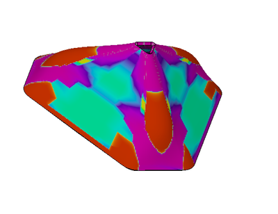

TrippyLighting
While Jeff might be surprised and unhappy that this does not work I am not 😉
It simply isn't a good idea to create a loft like this because it usually generates terrible geometry.
Below is an image of the curvature map (Inspect-.Curvature) map.
The patchy look is likely reason that this does not thicken.

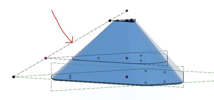

chrisplyler
Weird. I didn't use any rails at all, or adjust anything during the loft process. My pyramid comes out untwisted, the curvature is reasonable and uniform, and I've got no problem thickening it as long as I don't squeeze those small radii at the top too small.

TrippyLighting
How did you manage to magically make that edge straight ?

chrisplyler
I used this line between the bottom and top triangles, project/intersected it into the middle sketch to size the middle triangle with.
And then I adjusted the fillet radii of that middle profile by eye after the fact.
Now I've realized I could have made that line - not from the construction triangles - but instead from the profiles themselves, and used a tangent arc coincident to that intersect point to let those radii automatically be correct. That would be better than eyeballing it.
I'm also wondering now if the middle profile is even necessary. Is there a design constraint that requires conical corners down to a certain point before the transition can begin? If you just loft bottom-to-top only, it's even smoother.
