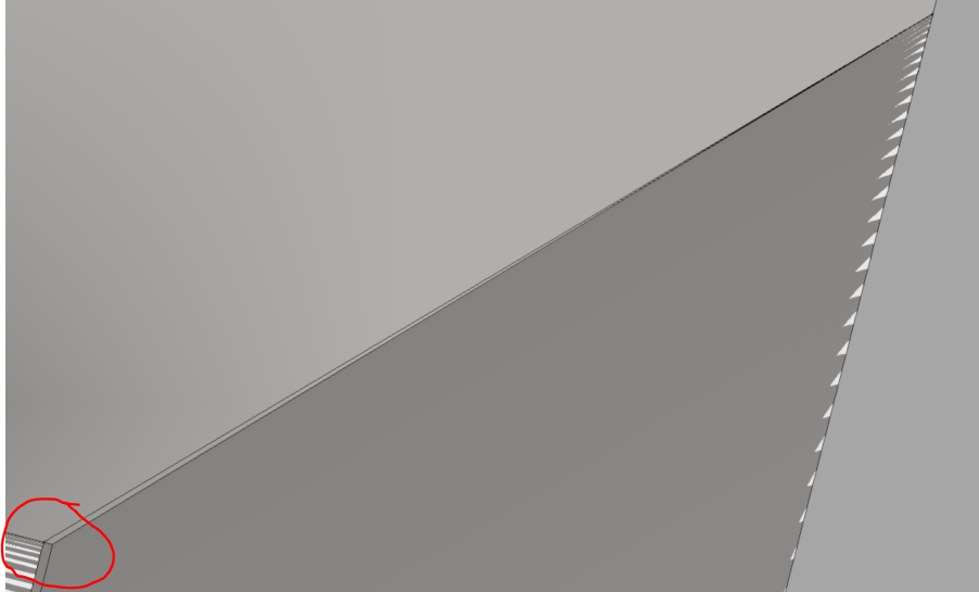

I found a few workflows, some quicker than others but the final problem is the lack of the ability to extrude from a double convex shape or bend a flat shape. I am sure you saw this right away but I had to try things. This angle should be 90 deg...

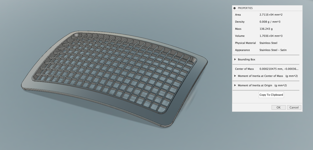

TrippyLighting
Does that look about right ?
Message 11 of 108
Neil_Cross
Hi Peter - I wouldn't confirm or deny if that's right or not as I wouldn't want the correct answer to be available for everyone to see! Part of the mystery of the challenge is that people don't know if they've done it right ;0)

TrippyLighting
So I modeled this in ZW3D with a method I assume much, much closer to the one that is likely used in Inventor.
Needless to say it only took a small fraction of the time and was straight forward.
I exported as .step, imported into Fusion 360, applied the SS material and took the properties. I am off by 2 milligrams on the weight compared to my Fusion 360 design. Close enough in my book, because:
1. We are exporting/importing NURBS surfaces and the algorithms in ZW3D unlikely are to be exactly the same as the one in Inventor.
2. The Fusion 360 design might not be milligram comparable to the one from Inventor due to the fully manual modeling approach required by Fusion 360. While both use the same geometric modeling kernel I would not be surprised to see some difference.
Edit:
I did another little experiment. I removed the chamfer of the model imported from ZW3D and re-applied a Fusion 360 native chamfer of the same size. That alone caused a drop in weight by another milligram.
Message 19 of 108
TheCADWhisperer
@TrippyLighting wrote:
Edit:
I did similar experiment in entirely in Inventor.
I removed the chamfer from flat state and then added it back in the double bent state and got a slight difference in mass properties.  Superimposing one part over the other shows slight difference in boundary edge (at least visual, I did not bother to attempt measurement of the observed difference).
Section view shown below.
Given that the contest shows the Chamfer in the flat state before "bending", I would say that is when it should be placed, but this presents a conundrum for modeling in software that does not have a Bend feature.
I would say the Bend feature itself is a confounding variable as I don't think it matches real world condition of pressing the prescribed flat into the double curvature.  I think the part would have to be molded in finished state to match whatever the Bend algorithm produces.
Edit:  Given this demonstration of the Chamfer feature, all of the other features would also be subject to the same potential differences in attempting to model in finished state vs "Bending" from the given flat state.
