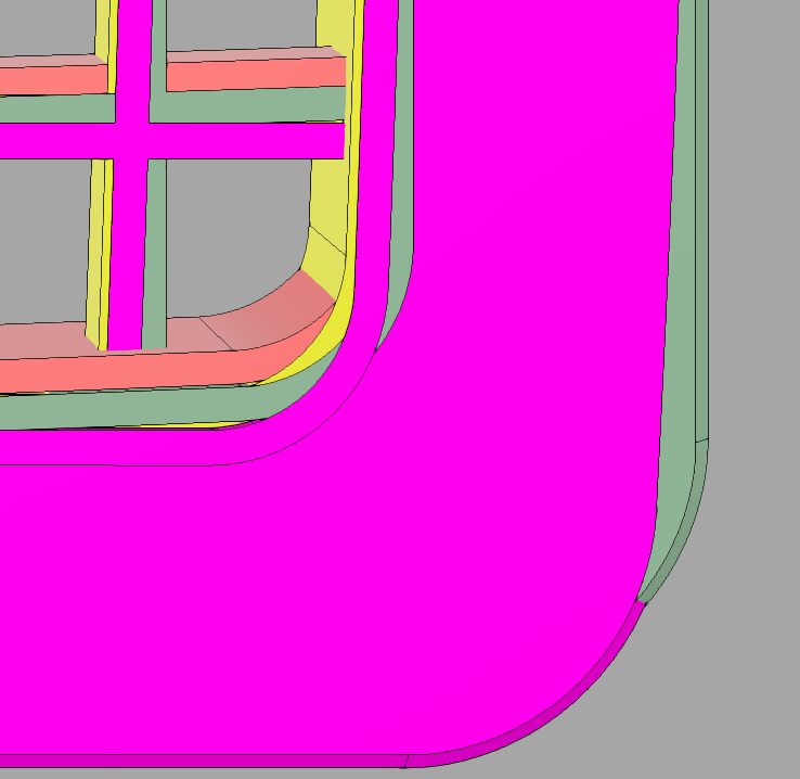

Done the same in ZW3D:
And here Fusion 360 native:
Message 22 of 108

TrippyLighting
@chrisplyler wrote:
@Neil_Cross
So...you're allowing some very minute variance in the Fusion property values relative to your Inventor property values? Or are the successful Fusion entrants nailing it exactly?
I understand how it could be difficult setting up such a challenge without expecting plenty of critical feedback. I still think it's a very cool idea, and even like this particular one. I would consider all that feedback as a benefit though...the discussions lead to all of us learning stuff from the attempt and from the discussions.
I appreciate you putting in the time to do it, and especially to participate in the discussion here. I look forward to more challenges!
I could not agree more and hope @Neil_Cross will put out more challenges like this. It is much more interesting when people participate who use different CAD systems.
From comparing my Fusion 360 geometry and the ZW3D geometry I can see where there are minor differences that account for the 10mg or so differences in weight and the other properties. I would almost believe that the actual geometry created by different softwares is much closer. Creating geometry is mainly handled by the geometric modeling kernel of CAD applications and we already have three different ones included in just this thread.
ASM (Autodesk Shape Manger) used in Fusion 360 and Autodesk Inventor
Parasolid used in Solid Works
Overdrive used in ZW3D
Here is a little screencast where I simply do a visual comparison of the geometry created in Fusion 360 and ZW3D.
For both components the Display Detail Control was set to fixed/high so viewport tessellation would have limited effect.
Still it is apparent that the geometries are indeed very close in most areas indicated by the visible Z-fighting. It also shows as explained earlier in this thread that the fillets show most of the deviation.
