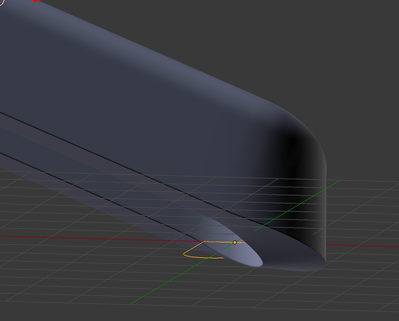

Hey guys,
I'm trying to sweep a profile along a curved path.
Bildschirmfoto 2017-11-10 um 11.23.26.pngBildschirmfoto 2017-11-10 um 11.24.11.png
What can I do to keep the vertical lines of the profile vertical? Right now the profile is 'tilting' into the curve, but that's not what I want.
Here you can access my design: http://a360.co/2zsurZt
Thanks in advance!

Message 2 of 19
Ezekiel12
Well... i dont know if I understand correctly, but it is tilting, because you created it it tilting.
I attached my file, where it is vertical to the line, because it sits on it vertical. But maybe I didnt understand something.

Message 6 of 19
SaeedHamza
create a plane along path using thee curve and then sketch your profile on that plane

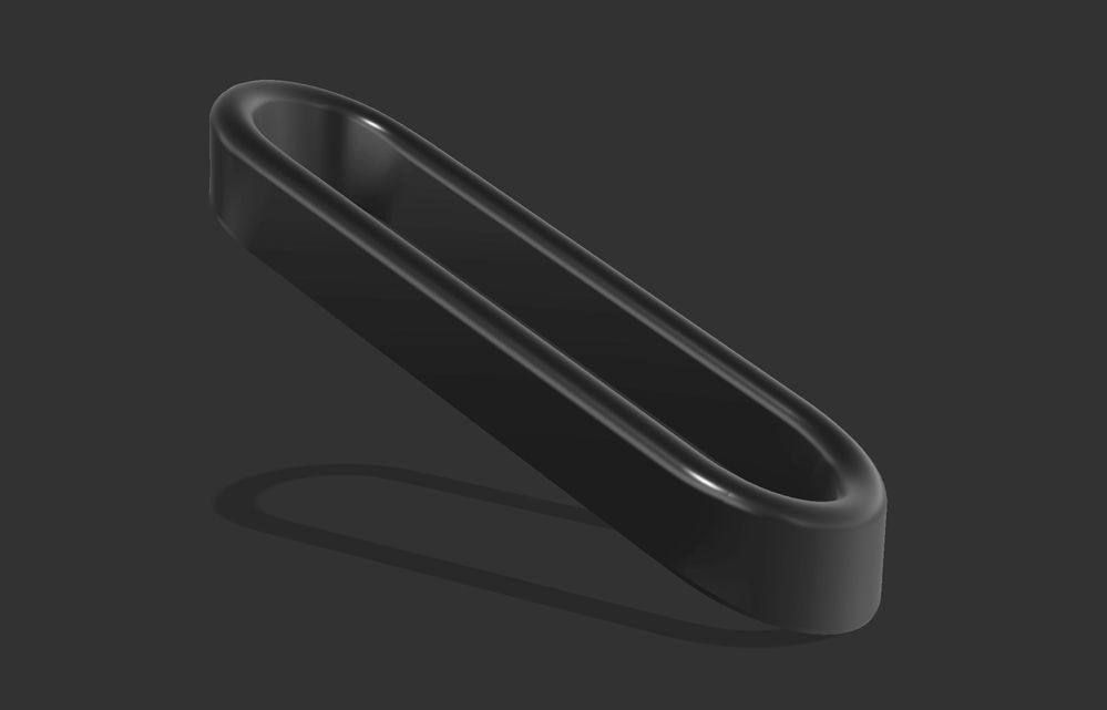

Message 7 of 19
wweikert
This is more or less the object I wanted to create. Any ideas how to do that in Fusion?
Bildschirmfoto 2017-11-10 um 18.55.45.pngBildschirmfoto 2017-11-10 um 18.56.42.png

wweikert
The curved parts actually aren't on a plane, more on a curved plane.
If you think of the inside of whole object as a tunnel, I want the floor to stay horizontal all the time.

Message 12 of 19
jasonhomrighaus
Here try this one, i used an offset guide rail then selected the profile and guide rail option, can make a vid if you want to flatten the base I used an offset plane and split the body, from there you could sweep on a base profile on the flat plane if you wanted.
Message 13 of 19
davebYYPCU
Your tunnel is doable, but not completely with sweep, you need the U-turn to be a Loft, due to the change of profile orientation involved at the centre of the end path curve.

wweikert
Thank you all very much, @davebYYPCU thats exactly what I imagined!

Message 18 of 19
wweikert
The final result:
I used lofts for the U-turns and sweeping for the straight paths.
Sweeping alone led to a tilt at the lower U-turn, at least with this profile and radius.
