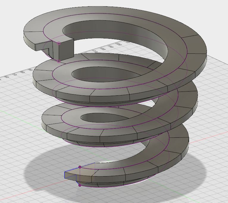

cekuhnen
Ah looks like there is some sort of an issue with the algorythm
with 0.99 it will work

gautham_kattethota
Probably some issue that has been fixed in internal builds.  Would you mind attaching your part to the posting?  I can look further into this.
Gautham

gautham_kattethota
Yes, I do see issues with sweep.  Let me look into this and get back to you.  Thanks for reporting this.
