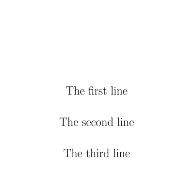

Hi TF360, Fellows,

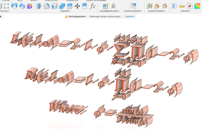

I have encountered a strange problem (well ... all of them are !!!) with multiline (multi-group) SVG files inserted into a sketch environment.

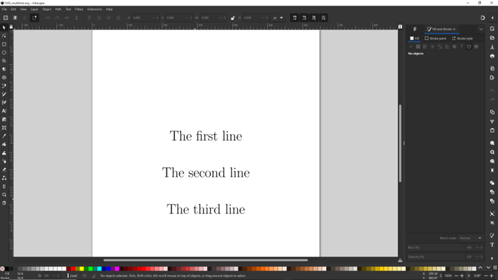

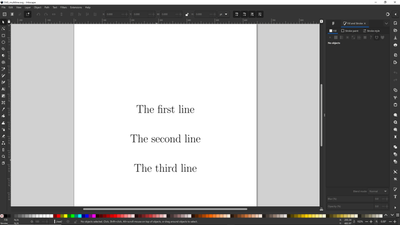

The first line is converted correctly. The following ones are not. The point the conversion fails depend upon the text string composition. The lines when processed/inserted separately are rendered as expected.
The SVG file produces coherent images in other popular software: Inscape, Chrome, ...
The example file  and the rendered sample are presented/attached below:
 GenericGenericInscapeInscapeFusionFusion

Fusion may support svg files but there is information that is implied instead of known in svg files that fusion does
not cope well with sometimes. While some svg files work perfectly well with fusion, others are a nightmare that should
be avoided at all costs. It is sometimes difficult to tell which is which.
While I agree that it would seem trivial to import something like text, text created by software that knows it is text
and has a text engine to render it, is not the same as fusion trying to import a vector graphic with information missing
such as scale and origins. This is a known problem with fusion that the devs know about. I don't think there is a fix
in the works to address this problem.
Ultimately fusion is a modelling program not a drawing package. If you look at the actual file meta data, much of this
meta data does not fit the svg standard. Fusion follows the standard to the letter (AFAIK) and if it isn't standard
meta data it will ignore it. This even happens with dwf files from AutoCAD and that is made by the same company.

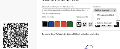

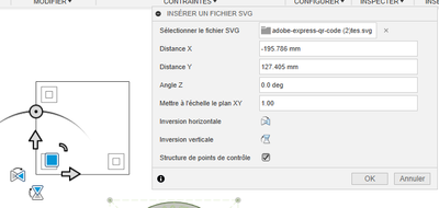

I wonder that also what seems a easy SVG, like a Qr Code do not open right in Fusion (picture is Qr code create  in Svg export format from Adobe express )
and how it open in fusion
well , I have seen that it is possible to find with other Qr generator a normal attempt result directly in SVG, maybe I find a one On-line service SVG to SVG (svg wo do not work in Fusion to SVG wo Work in fusion?)

The best way is to convert text into paths.
Regards
Message 10 of 11
MichaelT_123
Hi Herr Felsentreu,
So, ... as I understand it, you "filter" the SVG file in Inkscape before importing it into F360, don't you?
Regards
MichaelT
MichaelT
Message 11 of 11
felsentreu
That's right. Paths are the way to successful paths.
