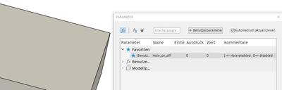

I want to create a variant model that controls multiple variants with one parameter.
I have now managed to do this in a roundabout way, but if I could activate and deactivate operations in the timeline, the task would be easy to solve.

So far, I have been able to control such tasks with the help of a table
                                                           Hole                d1
Block 100 long without hole         0                      100
Block 150 long without hole         0                      150
Block 100 long with hole               1                      100
Block 150 long with hole               1                      150
Using the Hole parameter, I was able to enable or disable the operation.
If I inserted the component into an assembly or derived the component, I was able to select the variant.
If they mean something similar by "Configurations", then that would be exactly what I need.
