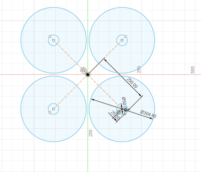

TrippyLighting
If your propellers are 12" in diameter (304.8 mm), then their center-to-center distance needs to be at least 435mm.
Message 23 of 52
gbkwiatt
I will probably use 10" or max 11" propellers.
But given that diagonally from arm end to arm end its 800mm it should be fine for all the options. But that was the the reason why I also want to be able to do it myself,  I might want to scale it down to be slightly smaller
