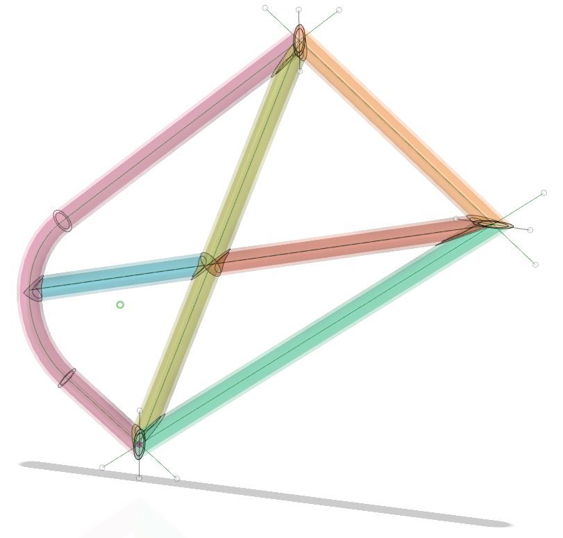

Personally, I would use sketch(es) at the top level to create a wire frame representation. At miter joints, you'll want to extend the lines and add a short line representing the miter angle.
Then I would make a new component and pipe one line. Make another new component and pipe the next line. Etc. Etc. Etc. until I had the whole thing piped.
Then I would go back and split body using those miter representation lines. Remove the extra bodies this creates.
Combine/cut/keep pipes that need to be drilled so their ends fit around other pipes. Remove any extra bodies this creates.

You've got the right idea, but the wrong implementation.
He should decide on groups and then make a Component for each group. Then he should make SUB-Components within those groups as appropriate. For something like a tube frame chassis (and really most stuff) you want each individual cut pipe to be a Component. If you have them as multiple Bodies inside a Component, you're really limiting yourself.
Message 9 of 36
chrisplyler
in reply to: Anonymous
In the pictures you provided, it appears that the design as predominantly planar. Sure, you will need several different planes, but that's no biggie.
I would start with the floor plane. Sketch all the lines on it that ARE planar. Center one of the symmetrical cross bits on the Origin, and sketch the rest of it relative to that.
Then, where stuff needs to start angling up, pick one of those lines you've already sketched, put a plane-on-an-angle on it, and start sketching the appropriate stuff.
Start with the flat floor stuff. Then work up around one side. Then mirror that side stuff. Then connect the sides together where you haven't already.

In fact, the planes are a good way to group it.
Make a Component for each planar set of pipes. Make the plane you need within that Component. Make the sketch within that Component. Then make a new sub-Component for each pipe.
When you have a Component with sub-Components inside of it, you will notice that the "container" Component icon turns into an Assembly icon.
When you start welding, it makes sense that you will probably weld up planar sets together first, as that suits clamping stuff to a welding table, right? So it's kind of logical to organize things this way.
You might do something like this:

You would Mirror Component for Angled Floor Members, Left and Side Members, Left, and then rename the mirrors as Angled Floor Members, Right and Side Members, Right.
Make sense? Do the same sort of stuff for the Cabin and the Rear Clip.
