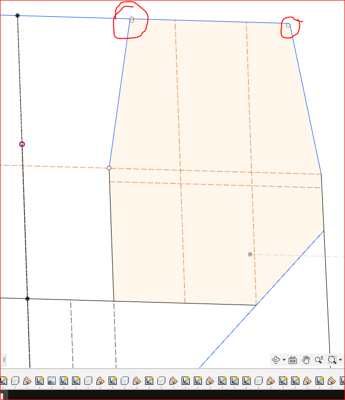

You are on the right track, some concern is the white dots, that are in mirrored sketches, which means the corners are not connecting, or more likely the mirror line is not in the middle of the sketch.  Not all is mirrored?
Work towards all black lines in the sketch, more dimensions.

Ah I see, I bet you're right about my mirror line. Ill go back and correct that and then re-mirror those lines.

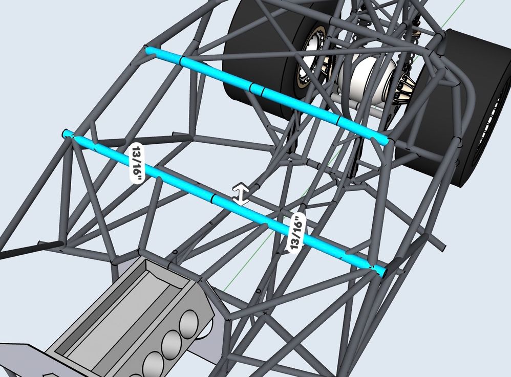

The problem I have with not being able to create both sides is that I need tubes that connect from one side of the sketch to the other. Should I just make a line through the center to connect them to? That way I can mirror the line later to make it go the whole way across?
Also, I'm not sure how that would affect the final model, because the tubes that connect one side to the other should be one, solid tube.
I hope that makes sense. I've attached the new file I'm working on now and I'll make another post with old screenshots from my first design to help explain.
Thank you for your input, I have been attempting to apply it to this model.
Message 31 of 36
These are two of the bars that will need to connect the two sides togetherThese are two of the bars that will need to connect the two sides together
I may be able to accomplish this using planes, like has been suggested. I'll attempt to do that for now.

Make the sketch lines for those cross bars all the way across. Make sure they are symmetrical across the center line of the car. So the crossbars can be one piece. And when you mirror the side bars, they will be in the right spot at the other end of those cross bars.
Now, if you've got some bars that are NOT mirrored - bars that are unique to one side or the other - make those separately after you've mirrored all the rest.
