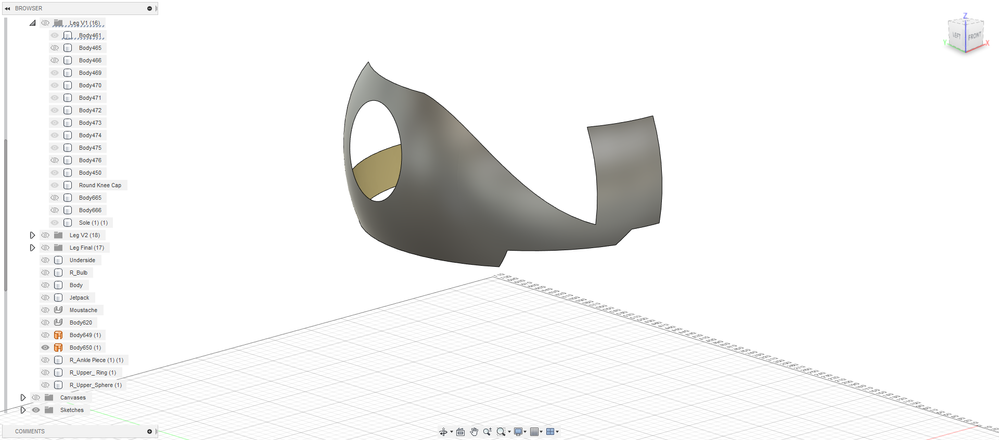

I'm probably being incredibly thick with this, but I've been struggling the past few hours with trying to make some very specific cuts, and it's getting me frustrated. 😖 I feel like I'm unable to make any progress until I can get these areas sorted out. I've tried adding the lines/cuts to a side sketch/profile and one from the front, and neither one are getting the desired result. I've even tried extruding from the lines as Patches and splitting the faces from that. The ideal solution would be to uncheck the Extend Splitting Tool because checking it is adding the cut all the way around. But usually, every time I uncheck it, I just keep getting an error. 😞
It always says 'no intersection between targets and split tool' and I'm not entirely sure why or what I'm doing wrong. So if I can't use that method, I'm not sure what the best approach is for achieving the desired result.
Splitting this line from the side just looks too wonky from the front, so figured it would need to be done from the front sketch.
But then... the line is too far forward compared to the side sketch. Not to mention the cut around the back, which I don't want. 😫
I mean, I can try adding the lines/cuts a bit further to the side in the front sketch, but I imagine that'll only help so much. I dunno... I'm probably overthinking this as usual, but my mind is drawing a complete blank. 😕 I mean, I might think of a solution once I come away from it, or before someone else responds, but I'll attach the file. I'm always open to new approaches/workflows to solve an issue like this. 🙂

I am coming in late on this but I think you are trying to sweep a cut around your body.  The video will show the basic process so you can replicate it in any position on your body you desire.  By the way, I finished off your mustache.  Model to follow is attached.

That is exactly the technique.  The path for the sweep will be the edges of the offset face(s).

Yeah, so I understand how to use the Sweep Tool now, or at least - have a better understanding, but I'm still not seeing how this allows me to combine these Surfaces together with the original Body so I have the added cuts made. Playing around with the settings isn't getting me anywhere, sadly. And if I try to do a Sweep with one of those Surfaces I made, I just get an error saying the sweep couldn't create a valid body. So I'm not sure if there's a misunderstanding to what I'm trying to achieve or if I'm still misunderstanding what I should be doing. 😞

The offsets are just used to create the paths.  Once the paths are done, they can be removed (not deleted).

Since the ends of this cut ended up on angled planes, I had to use Surfaces to create a tube with angled surface cut ends to create a solid tube that followed the path you wanted cut.  I then used the Combine command to cut the solid tube from the main body to create the cut.  Probably a little beyond your understanding at this point.  You can review the process by stepping through the features marked beginning with the red arrow to the left and moving to the red arrow to the right.  Model is attached.

That cut is done exactly the same way.  It would probably help to turn visibility of all sketches and bodies off except for Body649.  Once you have created the sweep turn visibility of "Body" back on and complete the sweep:
