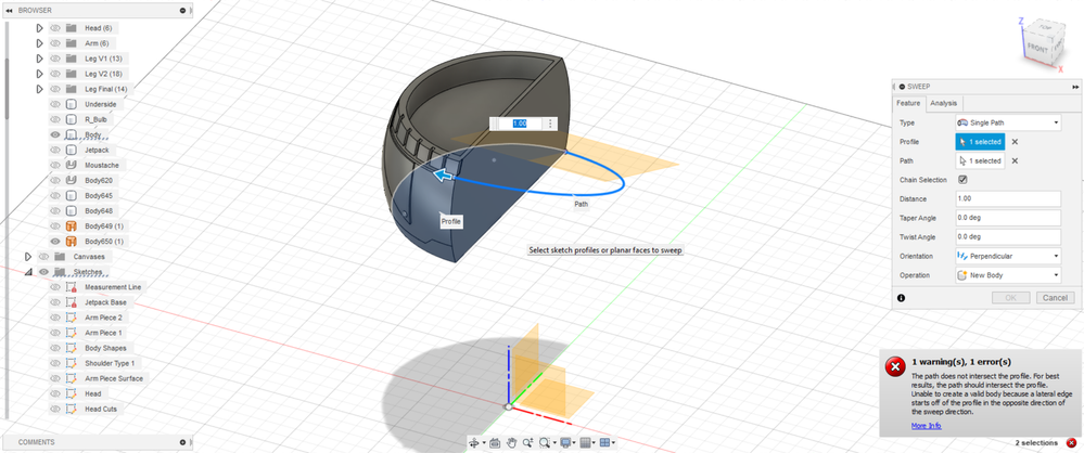

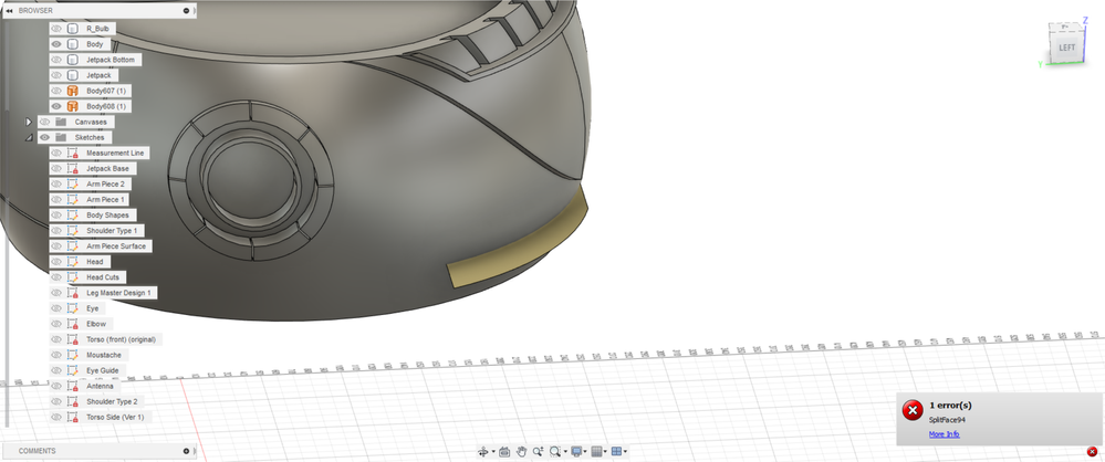

I'm probably being incredibly thick with this, but I've been struggling the past few hours with trying to make some very specific cuts, and it's getting me frustrated. 😖 I feel like I'm unable to make any progress until I can get these areas sorted out. I've tried adding the lines/cuts to a side sketch/profile and one from the front, and neither one are getting the desired result. I've even tried extruding from the lines as Patches and splitting the faces from that. The ideal solution would be to uncheck the Extend Splitting Tool because checking it is adding the cut all the way around. But usually, every time I uncheck it, I just keep getting an error. 😞
It always says 'no intersection between targets and split tool' and I'm not entirely sure why or what I'm doing wrong. So if I can't use that method, I'm not sure what the best approach is for achieving the desired result.
Splitting this line from the side just looks too wonky from the front, so figured it would need to be done from the front sketch.
But then... the line is too far forward compared to the side sketch. Not to mention the cut around the back, which I don't want. 😫
I mean, I can try adding the lines/cuts a bit further to the side in the front sketch, but I imagine that'll only help so much. I dunno... I'm probably overthinking this as usual, but my mind is drawing a complete blank. 😕 I mean, I might think of a solution once I come away from it, or before someone else responds, but I'll attach the file. I'm always open to new approaches/workflows to solve an issue like this. 🙂

Sorry, I'm a bit confused with being able to process what you mean. This is where I find videos and video explanations easier to understand when it comes to Fusion. A written explanation takes me a while to figure out exactly what and where someone means. 😅
Also, the bottom split that runs around is what I want to avoid. Based on the references I uploaded previously, it's only at the front of the torso and I can't seem to figure out how to avoid it cutting all the way around. Similarly for the vertical line at the front - I mentioned previously that it looks too far forward.
Message 6 of 42
t_smith5
I've even tried positioning the line at the front more to the left, but still can't make a split in the area I want without it cutting the back, too. 😕
Unchecking the extension just gives me an error every time, no matter what mesh...
And I've tried extruding a plane from the line, but get the same problem.

Start with Plane Along Path. Select the edge (turn Tangent Chain off). Set Distance to 0.  Create a sketch on the plane.  Draw a profile to sweep.  Sweep the profile, cutting the main body.
ETFrench

Have you been able to create a Plane Along Path using the edge of the offset face as the path.  If so, create a sketch on that plane.  Add a profile at the origin of that sketch either U or V shaped. Sweep that profile along that path and cut the main body with that sweep.
ETFrench

t_smith5
I've seriously no idea if I'm even doing it right... 😕
