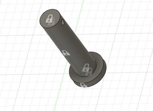

Good morning, we are dealing with the simulation toolbox in Fusion360, in particular for the static stress analysis. Anyway, we have some doubts related to the structural constraints: you can see in the pics attached the constraints that we have assigned. Namely, we have two loads, one applied on the hook (to represent the weight of the object transported) and one applied on the pulley (to represent the force of the crane).
Can you help us in understanding if these constraints are correct or if it is better to make different decisions? Thank you in advance.

If the displacement was excessive (not in this case) I might increase the width of the bushing to limit the inward displacement.  Split faces for the bushing contact and add Frictionless constraints to the faces.
Next we can test the Pin.
Split the faces for contact with the bracket and with the bushing.
Add the Pin Constraints and the Bearing Load...
