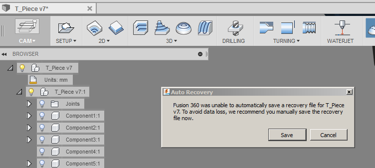

HughesTooling
Here's a screen grab. There were no file waiting to be recovered and I don't use Automatic versioning. I've only been seeing the error for the past 3/4 weeks and it's always with an untitled document left open.

Okay, I finally got it! Thank everyone!
This is more of a save reminder. I'm not sure it's technically a bug... With that said, I'm happy to take your feedback to the development team. What do you think it should say?

HughesTooling
It makes sense now you've explained it, Fusion is trying to save a recovery file for an unnamed document. Maybe the first part should say something like Fusion can't save recovery files for unnamed documents and the second part of the warning should say "To avoid data loss, we recommend you save Untitled now."

HughesTooling
I thought this was only happening with unnamed documents but I just got the error on a file that has been saved and is at v7. Maybe you could give a warning the file has not been save for X number of minuets or something but I don't see why it's warning about a recovery file.
