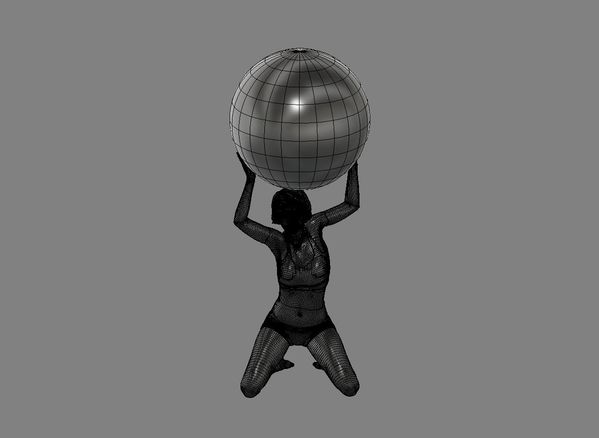

woman holding a ball v2.jpgbrake the body in to parts  in different files and do what your going to do and then assemble in a master file . I am working on a daz3d model right now and I am pushing the limit of a pc with 16 gb of ram .
so take the most left or the center model allone . then go in to sculpt mode  and go to the bodys in the tree drop down the bodys tab. Selecte all  but the top master body and right click to find convert . when you get the convert dialog use the mesh option ( it will output a smooth t spline mesh and ram heavy ) . I am not sure how long it will take you but you may want to walk away for a half hour or so . if you got another way of watching youtube i would watch some videos on t splines .

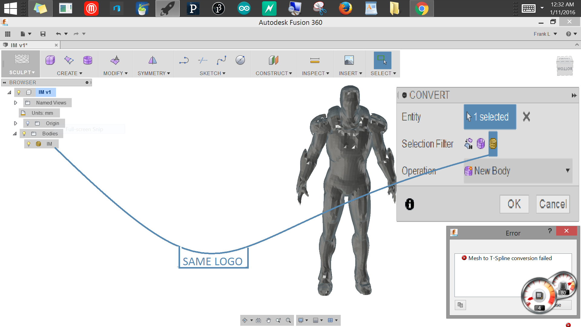

THABKS FOR THE SUPPORT GUYS
Capture.PNGAS DIRECTED AND I GOT A ERROR, WHY?

TrippyLighting
Importing the mesh into Fusinon was not problem, but it could not be converted into a T-spline. Fusion 360 returend a termendously helpful error message: "Mesh to T-Spline conversion failed" 😕
I looked at the .obj in Blender and it looks like the topolgy of the mesh is likely the problem.
  • There are a small number of triangles in the mesh. This is more of an observation than a problem.
  • There are a nmber of N-gons in the mesh.
  • The mesh folds over on itself in a number of places and this would creae an implausible T-Spline.
This mesh needs to be cleaned up some before it can be turned into something useful fo Fusion 360.
after that is run it outputs a t spline mesh not a standared one . it is labled wrong !
Message 36 of 174
TrippyLighting
The icon in hte browser indicats what type of object it is. Currntly it is a mesh.
When you attemy to convert it, the window that pops up also lists that same icon, but the label says "Seletion filter" and that ype of mesh is one of the filters.
tha does not mean that you've converted it into a T-Spline. That does not work because the topology of the mesh does not allow that.

PhilProcarioJr
I checked the mesh, 3 problems were found on my end:
1-Non Planar Quads
2-Triangles
3-Its not a water tight mesh
This mesh doesn't convert to a T-Spline because of reasons listed above. At least not on my computer.
This mesh can be converted to a brep and all faces can be sketched on, but in this case It is of little use, but it works fine. I converted it and cut a hole through the mesh.
Performance was not very good though. Proof here:
If you really want to work with this model in fusion, make it water tight and get rid of the triangles. Also break it up into body parts and work with each one separately.
The way I converted it to a brep is here:
http://autode.sk/1S6ApSL
Just my 2 cents.
