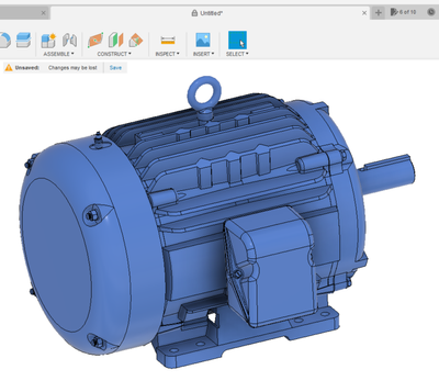

For the past few days, every time I try to upload a STEP or IGES file, it hangs and fails. Never had issues before.
Oddly, when I use the process to directly upload an item from McMaster, it works. Sadly, McMaster doesn't have what I need.
Is this something new?
Edit: I uploaded the same file to Autodesk's viewer, it displays there just fine, so it's not a corrupt file.
EDIT #2:
The AD viewer has a function to "open in Fusion 360". Pushed the button, and it worked!
Still, why do I have to use a work-around? Why doesn't this just work in F360????
