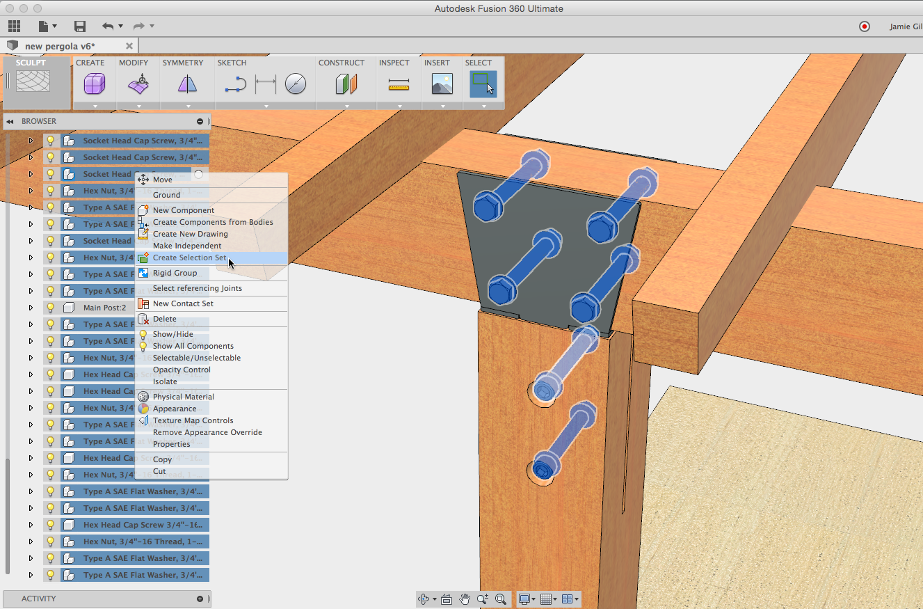

in the images below I created a selection set so I can quickly toggle visibility of multiple items at once.
Select your components and create a selection set.
one click of the desired selection set, I named the set Fasetners in this case for quick identification, selects all the components in that set
With the selection set selected you can right mouse click in the modeling canvas and toggle the visibility of all the components at once. Repeat the selection/toggle to turn the visibility back on.
