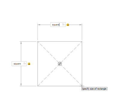

Message 6 of 11
This is what I did

Message 9 of 11
JHRendon
You should add a parameter with the dimension you want
so when you make the sketch add the parameter to the dimension
the same when you extrude it
so when you want to change the cube size only change the parameter dimension.

laughingcreek
take a look at the attached. double click the dimension and change the value.
Message 11 of 11
This works perfectly, Thanks!
