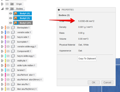

Hello
is there a way to find out how much square meters my model is?
I'm going to make this bench that you see in the link, and I want to find out how many plates need to be used, without using the arrange tool.
https://a360.co/426xdOv

i dont think that is rigth ,if you only click on the topp plate in model then you get 2.613 area?

1. you can define m as a unit in the document settings in the browser.
2. note that the properties show the entire surface of the part, i.e. top + bottom + surface of all edges.

Bunga777
I have computed the area by copying only the necessary part.
I believe that this should have produced the correct result.
I will duplicate the surface by offsetting it.

Select all the surface bodies and then choose "Properties" from the right-click menu.
The result shown here represents the surface area of the board.

g-andresen
Try it this way.
So you can also determine the edge lengths "loop" for a plate.

Yes I wonder if the figure offered in Scientific notation is the total surface area?
Message 10 of 10
g-andresen
Body Properties display the sum of the bounding surfaces, while Inspect Measure allows individual surfaces to be selected.
