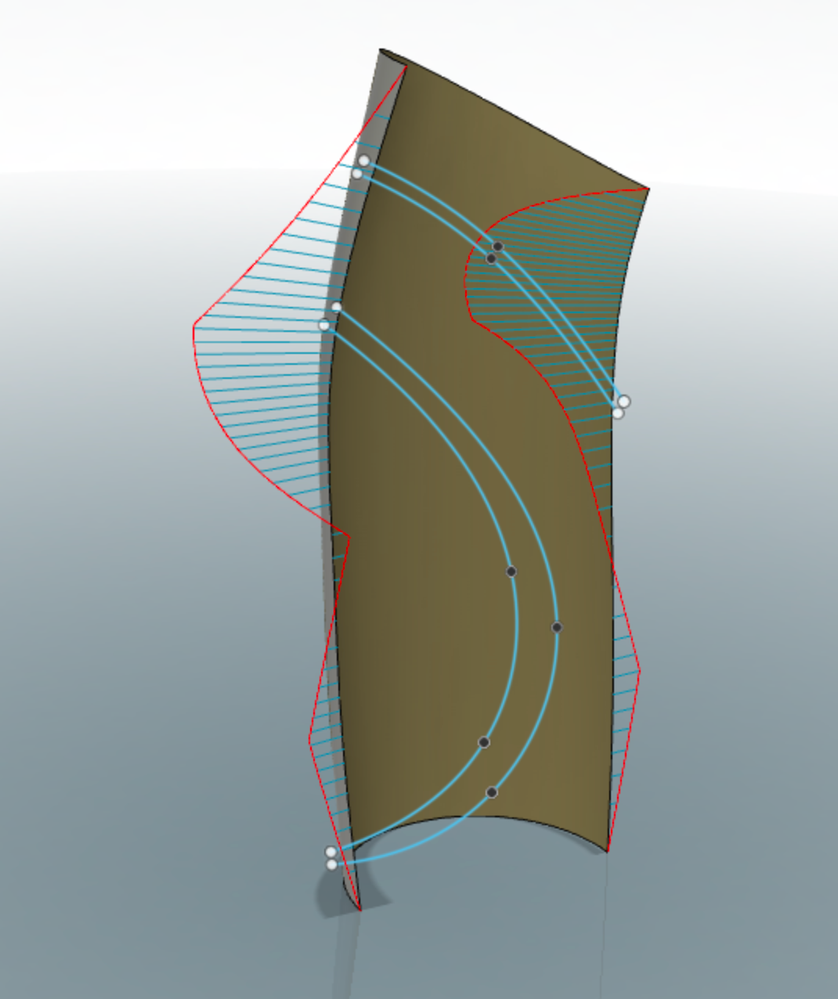

TrippyLighting
I understand that you are following a tutorial, but honestly, this tutorial is amongst a number of tutorials from Autodesk that shows bad techniques. Something I am sure you are not aware of is curvature, which is important when modeling with surfaces.
If you model a T-spline and then cut it the curvature of the resulting edge is pretty terrible and in more complex models can easily lead to modeling problems.
I applied the Inspect->Curvature comb tool to the edge of the split T-spline and you can see that the curvature is uneven and jagged.
This part really does not require the use of T-Splines either as it can be created from sketches and curves by lofting and then results in much better geometry.

fergalt
Hi Trippylightning, Is there anything I can do now to fix my model?
laughingcreek
when you "split body" with a curve, the projection is normal to the sketch plane you selected when creating the sketch.  You didn't select the same plane as the guy in the video.  even though you made the curve on the xz plane, the sketch was actually created on the xy plane, so it is trying to project UP from there to do the cut.  that sketch should have been created on the xz plane.
fergalt
Hi LaughingCreek,
I redid all the steps on the xz plane but it still isn't working, is there anything i'm still doing wrong?
Thank you!
laughingcreek
looks the same as before, but I can't tell from just the pic, can you attach the current model?
