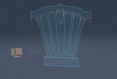

Hello Fusion forum,
Working with the excellent input from jhackney
Chandelier Assy - JRH.f3d, attached
some additions were made to have a complete
chandelier assembly:
When the assembly was disassembled and made
into separate parts for printing it
was discovered that the top part of
the six panels is too big for the Bambu
Carbon One printer. The printer plate
had been measured at 254 mm (ten inches) but
the printer will not print larger than
229 mm (9 inches).
Back to the drawing board.
The panels were reworked to a smaller
size.
chandelier_assembly_250811.sfd, attached
Struggling with how to fit the panels together
so they make a hexagon on the top
and a hexagon on the bottom as shown in
The angle for the joint at the top and the
bottom has not been set for the mitered joint and
key block. The plan is to, after
the panels are set use the assembly
to discover the angles for the
faces where the mitered key joints
come together.
Studied jhackney's solution to figure
out how it was solved. The timeline
suggests that a circular pattern
was used. Not exactly sure how this was
done and some hours of study
and experimentation have not led
to a solution.
Also tried more than several combinations
of Align and Joint. It is thought
that making a joint between the top
and bottom panels before Aligning or
Jointing keeps the top and bottom
moving together.
Any ideas on how to approach the compound
miter are appreciated.
Thanks.

jhackney1972
You have a design problem in the lower half of your panel.  It is not symmetrical so I cannot achieve a clean joint on the bottom of the assembly.  I have included my beginning assembly layout, where you can see the problem in the bottom joint, and a model which matches up two panels to show the symmetry problem.  When you solve the symmetry problem on the lower section, let me know and I will finish the assembly.

TrippyLighting
These problems are encountered because the underlying sketches are inadequate.
None of the objects in the first sketch is fully dimensioned and constrained. That makes the design very ... fragile.
A lot of sketch work and debugging can be eliminated by sketching only half of the object and then mirroring the 3D geometry.

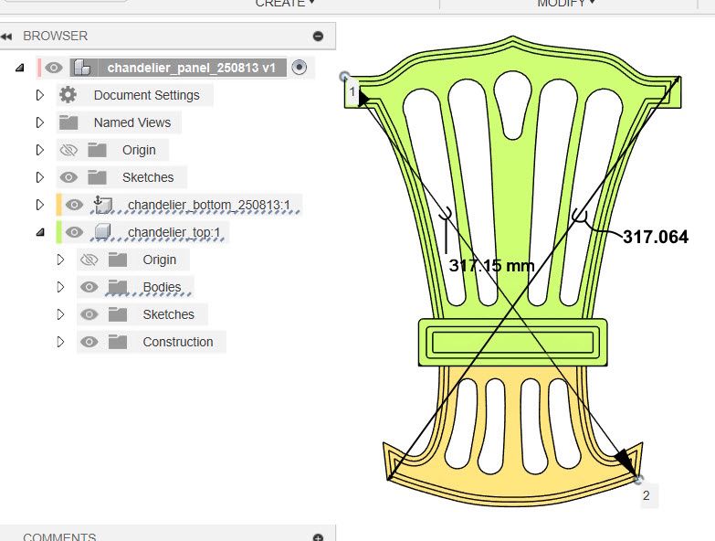

pittsallen
Hello @jhackney1972  @TrippyLighting @John_Wright  @laughingcreek and the Fusion forum,
Have reworked the bottom panel to eliminate the symmetry issue. Found two
points on the lower right side where there should be one point that
were fouling the works.
Using jhackney's diagonal measure check the panel in attached file
chandelier_panel_250813.f3d
the diagonals, which were 3 mm off are now .8 mm different. While
not perfect, it is hoped that that is close enough to make a better
fit of the miters on the bottom.
(jhackney, how do you get two measurements to show at the same time?)

jhackney1972
Well you modified the lower portion of the panel to get a descent joint at the bottom but that joint cuts into the feature detail.  I think you still need some modification.  The video will help you understand.  Model is attached.

jhackney1972
Your assembly is attached.  The Miters look good and they do not interfere with the panel features.  I have attached a single panel also.  I did not do the miter key as I need you sign-off on this assembly before I do anymore.  You of course can add them yourself.  If you have me do them, please tell me the approximate size you desire.  Your model still has "color" in the timeline you see to be ignoring.
If this answers your question, please select the "Accept Solution" on my post. If you need further help, please ask.

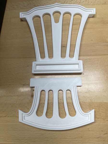

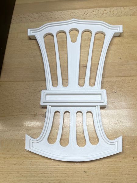

Pheidippides ran twenty-six miles from the plains of Marathon to the city of Athens
uttered one Greek
word and dropped dead. The word was 'nike' or in English 'victory'.
A substantial nike (not the tennis shoe kind) was acquired today in getting the panels
to print.
The completed chandelier will require twelve panels, six
top and six bottom, six legs the centerpiece and the rosette.
Each panel takes about two and one half hours to print.
Thanks to the four gentlemen, and especially Mr. Hackney for their excellent counsel and advice.
Will post photo when panels joined.
Allen

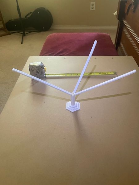

Perhaps rectification could be accomplished by demonstrating the fruit of our labors.
Six individual panels were put together from twelve top and bottom pieces as shown in
forum thread 'Son of Panel Fit 250812' post #15.
The challenge then was to fit the six panels together in a regular hexagon,
The usual process when supergluing 3D printed ABS plastic pieces is to dry
fit to check for correctness, place the adhesive and clamp.
But the dry fit was problematic because there is no way to clamp two pieces at a
60-degree angle. Tried rubber bands around the middle with no luck. Considered
building a hex rig for clamping.
Finally, after several hours of struggling it was decided to glue them one at time
without a dry fit of the complete object and rely on the 60-degree bevel to
get a regular hexagon at the top and bottom edges
I must be living right because it worked and when the sixth panel was set in place
