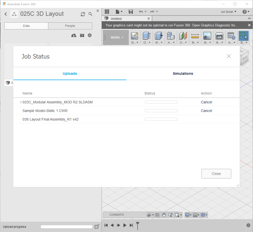

I’ve been trying to upload a new assembly to Fusion 360. It doesn’t show any signs of making progress. I uploaded it the same way that I uploaded a previous assembly (uploading all files in the assembly and choosing the top assembly file), but it just doesn’t seem to be working this time. Can anyone help me with this? I am currently uploading the assembly to mediafire so that I can share that link with someone that might be able to help me upload it to Fusion 360. This is all that I see. I left it uploading overnight. No progress.snip_20161031121719.png
Message 36 of 37
Phil.E
It's possible the translation service is confused about the assembly structure. Do any of the sub assemblies contain sub assemblies?

Message 37 of 37
Hi Phil,
Thank you for the response. There are sub assemblies in the assembly, but I’ve uploaded a similar assembly before. This one might a little bit larger, but the format is the same.
Jon Duran
