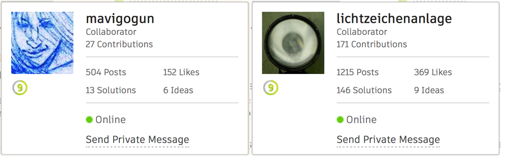

TrippyLighting
@mavigogun Id' say at the current time that @lichtzeichenanlage has got you solidly beat in the number of solutions provided and contributions(screencasts) on this forum.
His native language is German (so is mine) and while his vocabulary might not be as elaborate as yours it would appear it provides more bang for the buck. That is particularly interesting as his screencasts are not overly wordy 😉

mavigogun
@TrippyLighting wrote:
@mavigogun Id' say at the current time that @lichtzeichenanlage has got you solidly beat *snip*
It ain't a contest- and, even if it were, my efforts do not reflect on his. It also isn't the topic. This is more petty digression- now with a bit of tribal partisanship thrown in.   Not being a native speaker is no sin, nor obstacle we can't surmount.  Making the focus on ego is a mistake.
