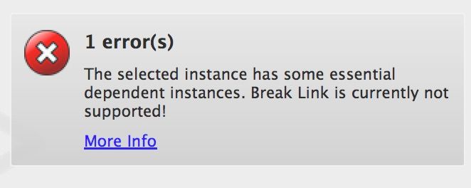

Message 14 of 42
maker9876
I tried to export as an .f3d before and got this message:
which is why sent an .iges file.
Just now created a duplicate of the file and started to break the reference links.
That worked for the first link.
But the second one (the first of the nuts) gave the following error message:
Anything else to try?
Message 15 of 42
Beyondforce
Usually you just break the links and that's it. I'll try to with what I have got.

Message 16 of 42
Beyondforce
I'm actually having challenges with it. I can't move the parts.
You should try to go to each sub component and break all the links! If you won't break all the links, you will keep getting errors.

Message 18 of 42
Beyondforce
1. Try to avoid linked components if you can.
2. Import the components to the MAIN assembly file and then create the Joints!
3. I won't be able to help you, if I can't play with the component.
You can create a test file, and in test file, you can just break all the links.
Ben Korez
Fusion 360 NewbiesPlus
Gript.app
| YouTube
