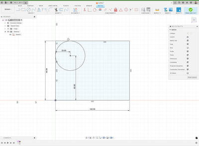

One of the main reasons that sketches should be simple is that a sketch is the foundation
of a model but it is the weakest link in the fusion tools. A simple example.
Fully constrained sketch.
Cut out the unwanted corner.
Notice the error in the lower right corner - unconstrained sketch.
In this case I only have to add a single dimension to fix it but I have seen sketches
totally destroyed constraint wise from a similar operation.
End result.
Take our original sketch.
Now use the tools instead.
You have ended up with exactly the same model but not only is the workflow
captured in the timeline, it is also a much more robust model and unlikely to break
down the track as the foundation is more solid. I don't know why fusion works
like this but it does.
