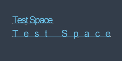

Typically in typesetting you can apply a negative value to text spacing to bring characters closer together. I was surprised when Fusion won't do this.

I would really like to see this feature implemented. I honestly think we are just needing to have this allow negative values and it would make fusion360's type tool worth using in the modeling space. I currently have to do all of my typography in illustrator or inkscape and export them as DXF and import them into fusion360 and frankly DXF are hard to work with in fusion360 too. I would MUCH rather use the type tool and stay inside fusion360 and not leave it's environment.  For an simple example of where this would be used, this image shows the kearning is far too wide on this font for text along a path. If we could reduce the letter spacing it would look fine though. Currently I have to expand the diameter of the path to make it look good but that isn't always an option. It would be ideal if the spacing could be character specific but at this point I'll just be happy with negative spacing as an option for the whole string.

@eric4XAGE  Text on path does have an option to Fit to Path so for your example you have some control in Fusion.

HughesTooling
Fusion even seems to deal with overlapping when path is too short.

This still doesn't solve the problem of not being able to make the text closer together, especially when used with straight text, needing to fit characters onto a surface of a part, when the designer seems to want half a book stuffed onto a tiny surface.   Part number, PO number, cast number, revision level, date of manufacture.....the list goes on....
If I make the text fit by decreasing the height of the characters, it can become hard to read, when all I want to do is decrease the spacing between the characters!

Although it's not as convenient as just using the standard text, fit to path with a line will decrease or increase the spacing between characters.

Thank you Mark Hughes! I appreciate a working solution, I still would love to see negative values as a feature of the character spacing but I will use arcs and lines with the "fit to path" option in my work flow now so I can keep my work inside of Fusion360.
