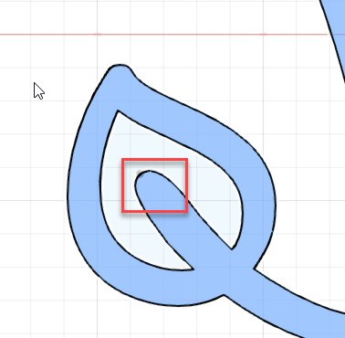

I made an .SVG from a logo on Illustrator, but when I import it to Fusion I cannot select only the fill part from it, it selects it all. I'm new to 3d and no idea how to solve this.

1. green means fixed > rightclick > unfix (somtimes > 2 times unfix)
2. look for gap left side using divide & conquer system
3. maybe share your svg* file or f3d (Fusion)

Message 7 of 27
LeonardoBN
The geometry is open at this position:
Are you going to Extrude it? At first glance SVG looks OK, but when you zoom it you can see some imperfections, like @laughingcreek said.

Message 11 of 27
t_lamourine
Screen Shot 2020-07-10 at 1.15.01 PM.pngScreen Shot 2020-07-10 at 1.16.37 PM.pngArea's where line not closed.  I find it's often easy to check if you pull a plane off the SVG, create a sketch there, and try to "project" the SVG items onto the new plane. the miss joints and overly screwed up area quickly point themselves out!  can also correct long segments of small connections by using the Spline tool to replace screwy spots from the original imports

Message 13 of 27
laughingcreek
That step over IS the gap.  one of the subtleties of how illustrator creates it's exports.

Message 17 of 27
jeff_strater
imported SVGs come is as "fixed" sketch geometry.  That is why they cannot be moved/edited.  You will need to "unfix" them in order to edit them.
However, be CAREFUL when working with SVG - it is easy to import an SVG that has way too many curves for Fusion to handle.   A Fusion sketch is not intended to deal with thousands of curves.
