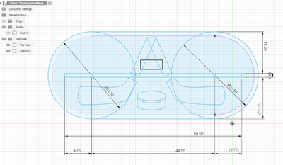

I'm sure this is trivially easy to fix (or else I did it in a way that it isn't) but I can't see how.
The shape is an ellipse (I drew 2 circles, connected by lines top and bottom). with a rectangle through the middle. Then I extruded to 3mm, filletted all the edges, and slapped an SVG on the face (I guess I created it as a new sketch). The SVG is too high and I'd like to move it down a tiny bit. But the sketch is locked and I'm not clear what's constraining the SVG.
This screen capture shows just the one sketch and all the green lines are actually locked, I just showed one in black because I also don't understand what the purple lines mean in Photobooth environment.
Any hints on how to fix this would be appreciated.

Imported .svg files come into Fusion 360 Fixed(Locked) indicated by the green color.  Black indicates geometry is fully constrained.  The lock icon indicates the all of the geometry in the sketch is fully constrained.
To remove the Fixed constraint, select the geometry, then right click and select Fix/Unfix from the context menu.
It is a best practice to fully constrain your sketches, but this can be difficult on imported geometry.
p.s. Purple geometry is projected with links to the original. To edit these, use the Break Link command on the context menu.
p.s.p.s. The blue area indicates geometry automatically projected into the sketch.  In my opinion, all of the auto project settings in Preferences should be turned off.

I couldn't find anything that would let me select all the lines of the SVG at once (other than CTRL 🙂 ) so I went ahead and did it that way, in bunches. Only took a few minutes. But now while most of them are blue, there's one rectangle where the options (based on Fix/Unfix) are green or black. I don't see why this one rectangle would be black, it's part of the same singular SVG. This screen capture includes the sketch with the other geometry. Obviously not constrained, which worked out well as I tweaked the dimensions (even if bad practice).
For some reason, the purple (representing the start/end of the "full round fillet" I guess) doesn't go all the way around. It's not serving any purpose for me but I don't like it being inconsistent. 🙂
Thanks.

Black is good😁 Blue is bad.  It looks like you have visibility turned on for more than one sketch.  It's a little easier to see what's happening if you only have the working sketch's visibility turned on.
Here are my Preferences settings:

In terms of the file I uploaded, I expected that when I selected the puck (or any other single object) that I could move it around either by dragging or by specifying a distance. But instead, if I select the puck (easiest to grab both parts representing the top and the face of it), when I either drag down or specify a Y distance, it just rotates.
Is rotating also happening to you if you try it? And is it what you'd expect given the model as it is? I'm trying to calibrate my brain to whether I'm expecting the wrong thing, or if my expectation of dragging around is correct, whether it's misbehaving because of the way I built it or some other reason. Really I wanted to move everything down and to the right (-Y and +X) but the black vs blue part throws me, so I'm using the puck as a smaller test.
Thanks.
Message 15 of 18
jeff_strater
I can't say how it got into this state, but what I see is that there is one fixed point in that part of the sketch that is inhibiting movement.  If you un-fix that point, it works fine.
I think SVG geometry is fixed when it is imported.  Somehow, that point never got un-fixed, is my best guess...

Thank you. I'm not sure what I'm doing differently now, but I selected the puck (both parts) and did the unlock, and now it works as expected. In your sample, was there a way to have the point that was locked identified, or did you just know what it was based on where the rotation was centered (the point that wasn't moving)? I was able to get the black square unfixed too, again I don't know what I'm doing differently but I'm happy I feel like I'm moving forward.
