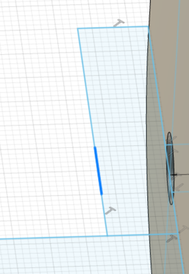

Sketch is fully constrained but not defined
mowen34
I have attempted to add additional constraints to every edge and vertex present however any additional constraint is met with 'Sketch geometry is over constrained.' In addition I have attempted to follow multiple youtube tutorials to no avail.
The text command 'Sketch.ShowUnderconstrained' returns:
'Under constrained points: 16, under constrained curves: 8'
The only fix that has worked is using the Fix/Unfix command on any line segment however that feels like the improper way to resolve this issue.
Any help and/or tips to avoid this situation in the future is greatly appreciated!

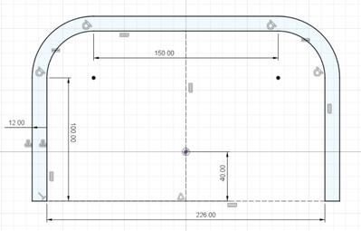

Here is one way to do it, and please note that this is a case where you're using the origin point to constrain your sketch, and if you don't wanna use it, you can always create lines/points that are fixed (fixed constraint) to be the reference for your dimensions.

The key in this sketch is to constrain as you go.
Dimension and constrain the first three lines and add a centerline for mirroring.
Offset the three lines and add the end line:
And finally mirror them:

I generally avoid Symmetry constraint (or Mirror) in sketch as it is a form of a sketch pattern.
See Attached file.
In fact, with Thin Feature the sketch can be simplified even further...

@mowen34 wrote:
Stetch4 is the one in question
Sketch4 is a 3D sketch.

sketch4 has been "moved" off the sketch plane, effectively making it a 3d sketch as far as fusion is concerned.  Not a good idea.
