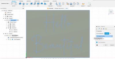

Now I exploded the text and clicked fixed/unfixed and I’m able to position the words. Thank you both for the assistance!  The issue now is in the manufacture tab.  When I select the geometry, I need to select every little section of each letter. Is there a way to “recombine” the word or another way to select the tool path, without selecting each section?

I’m almost there. When I select the single sketch it’s grabbing both the letters in sketch 2 and the outline of sketch 1.   Please see picture.

HughesTooling
You might get away without exploding the text if you hide the body while working on the text. Also the environment makes a difference as well.

Message 10 of 15
pdqevo
Please bear with me, I’m very new to fusion. If I just create a sketch with the text, how do I marry it to the stock?  Maybe I just answered my own question. Can I create text only and add the stock in the manufacture tab?

pdqevo
I thought I was doing what was seen in the video, but it's selecting more than the text.  Thank you for having a look

jhackney1972
You issue is caused by the Fusion 360 Preference setting that Projects the outside plate edges into the sketch when the sketch is started.  You can simply delete these extra lines as I did in the video.  If you are interested in turning this Preference off, the screen capture will show you where the switch is.  You will uncheck the indicated box.
Your select tool is not appropriate for the Trace operation you are trying to do so I selected a 6mm chamfer tool.
