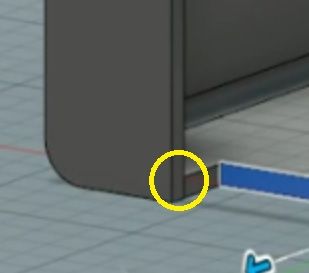

Hello

I didn't finish it, but you get the idea.

Here is a screencast to make it clearer

Hello
Thanks so much
Yes it is what I want
It is possible to receive project file?

mariusche
Thanks for screencast
but I did not understand exactly what you are doing when project the edge, project the same edge twice (in the timeline 38s-44s)

SaeedHamza
Never mind that, I was trying to get a closed profile to make a flange of the same outline of the main body that's all, you can forget about the projection and sketch your own
File is attached

mariusche
I need like this
Message 8 of 33
daniel_lyall
just cut that bit out then put a new flange in it have a look at the attached file

SaeedHamza
Okay, this is the same as the screencast above
Do you mean the whole thing?

@SaeedHamza Have a look at what I did, you just need to move the timeline to see it and if you have a close look at what @TheCADWhisperer did you will see there is not much differences.
A simple part like this you only need a sketch for cutting the shape out,(this is how I do it, it may not be the correct way to do it and if I am wrong I expected to be judged in a constructive way) I did it so you could unfold the cutout if you wanted to without unfolding the rest of it, or so the angle of it can be changed from 90 to 0 or 180.
Also when you make the flange if it looks like it's in the wrong spot change it's position useing what's in the drop down menu.
