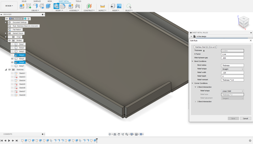

Like the title says, I am getting no response from Fusion to a change in the sheet metal rule.
I have two sheet metal models in this design I'm working on. One of them works perfectly fine and the other had no response to a rule change.
I even started a whole new design file just for the model that doesn't work (attached).
Anyone with knowledge about where or what I screwed up with this would be greatly appreciated.

I realize that, but my problem is the model I posted doesn't change when I change the sheet metal rule. For example if I open up the file I posted and change the sheet metal rule miter/rip/seam gap to be .01" and the 2 bend relief shape to be round with a relief size of Thickness * 3, nothing happens to the 3d model or the flat sheet.
I don't know why this is happening to this design specifically while other designs of similar shape and dimensions work fine. There has to be something simple I am missing here and I'm just can't find it.

Message 5 of 19
clarenceVH8JF
So I tried the same things you have done and they work the same as you show....
But the two 2 bend corners don't do anything yet.
Corner does not match settings.
The corner does not match the settings.The corner does not match the settings.
Flat pattern doesn't change either.
Flat pattern always looks like this.Flat pattern always looks like this.
These setting don't change it either.
Even if I change the settingsEven if I change the settings

@clarenceVH8JF  I think the problem is you are not creating a 2 corner bend because you're using 2 flanges for those corners.
If you create all 3 flanges in one flange feature it will work how you expect. See attached file.
