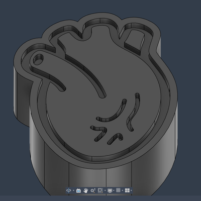

I'm trying to make a custom cookie cutter. For that I imported an svg file (had to clean it up a bit first) and then extruded away. The last step would now be to make the outer edges sharp. I tried chamfer, loft and sweeping tool but I can't get it to work. The outlines are somewhat complex but I just can't imagine that this is too much to ask from fusion. There must be a way and I'm just too inexperienced to get this done.
I would greatly apreciate it if someone could help me figure this one out. What is the best way to do this?
I attached the file if that helps.

Drewpan
I am unable to open your file as my fusion is currently updating however let's have a look.
My first impression is that at present what you have is a cookie stamp that will push an
impression into the cookie dough but not actually cut it. If you want the impression of the
inside but to cut out the shape then all you need to do is put a sharp edge on the outside
edge.

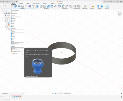

To do this I would change to the SURFACE tools.
Select the outside edge that you want to cut with and extrude a new surface the thickness
of the dough you want to cut. So 10mm dough you want a 5mm impression and cut the rest.
This means a surface 5mm tall and 10mm deep.
Go back to SOLID Tools and select the Thicken command and thicken up the surface to about 1mm.
Join the two bodies together with the Combine tool
Then use the Chamfer tool to put s small edge on the cutter.
I would use the Two Distance version and only cut half way or it will not
3D print very well.
It would probably be very useful to put tiny Fillets on the inside of the Cutter
so the dough doesn't stick so easily.
If you want to get fancy then you could either put a handle on the other side.
Or you could get really fancy and create a Block for Mass Produced Cookies.
A Quick and Dirty solution but should work.
Cheers
Andrew

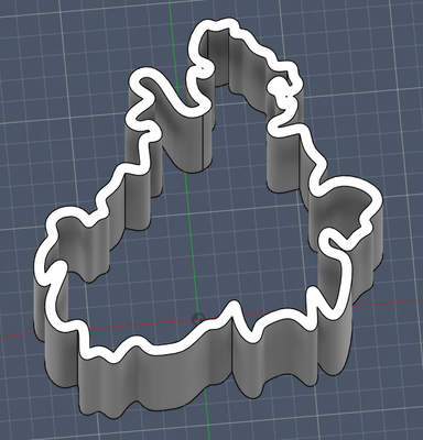

Mine is a simple cookie cutter and I want it with a V-shaped edge ay the bottom , but i can't figure it out since the figure is complex an I'm a beginner, but would like to earn. I've tried chamfering, extruding with an angle, lofting, surface lofting with no results. Here is my file, many thanks for your help

You need to strongly simplify the curves you sketched, so only larger radii are left.
How much detail do you think a baked cookie can retain?
I would attempt to reduce the number of spline fit points by 30%-50% and ensure that curves remain as large as possible.
