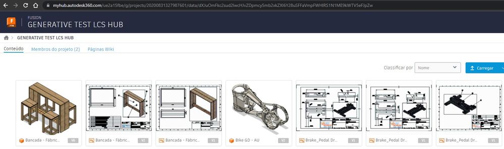

Hi, @charlie.buscher !
I believe that the best option for your workflow is to save all your sheet drawing files in a single project folder and access https://myhub.autodesk360.com/ via the web
You could invite a member to be part of this directory so that the guest will have access to all the project information.
I hope this helps you in some way with your workflow!

charlie.buscher
If I'm understanding correctly, using that method the viewer would have to have an Autodesk account.
I'm needing to "securely" share drawings with a customer who is not an autodesk user and I'd prefer to make them jump through as few hoops as possible.
The Autodesk hub is extremely useful for this sort of thing.
For now I've  integrated links to the drawings within our parts productions schedule.
