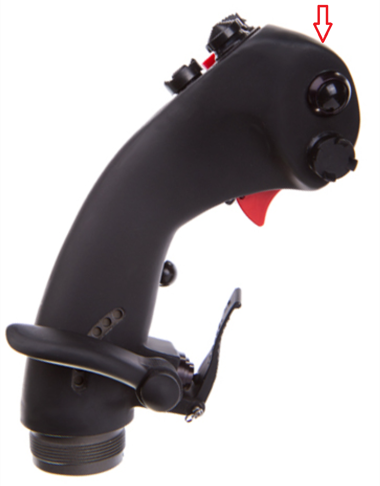

Seeking advice on modelling approach.
I've been trying various methods (Sculpting and 2D Sketching -> 3D Lofting) to model the below flight control grip but have not been able to achieve a 'clean' model.
What is the best approach to modelling such as this ergonomic grip that has some very 'tight' geometry in certain places?

Hi Guys,
I've hit a road block so to speak. I think this is where I've reached the limit in terms of my "current" abilities.
As per the attached pic - I'm trying to model the RHS of the grip which houses a "thumb switch", the "index button" and the thumb rest ( which I describe like a "T" section that merges from the thumb guard to the main grip body ). I just can't seem to make this section "flow" with the main body.
I've tried modelling them as separate pieces and as one continuous but I'm constantly pushing and pulling on faces / verts etc. and I just end up with a mess of bulges.
Any ideas of how to approach this section, or example tutorials showing something similar ?

beresfordromeo
 Hi @Anonymous
Could you please share your new file so that I can take another look.
On a separate note I pretty much worked out how to do the model in patch alone (or at least mostly). I haven't made a video about that yet, in part because I haven't finalised the ideas but also because I didn't want to clutter your discussion. Also I was also obviously missing some details which would be another reason to share your current file, particularly I am interested in your canvases and your base dimensions (you had some in your side elevation but it would be good to get dimensions on another plane or two).
So anyway if you are happy to share your file publicly then we can all see from the same perspective and perhaps come up with different ideas, I would particularly be interested to see a patch to tspline workflow comparison.

OK just to address your specific question about that part that you are having difficulty with.
These complex changes of shape are often better thought of as 'cut outs'. That is to say you would model the main body as a single body with extra material there and then use a new geometry to cut that shape into it. this could be done with a single body/single operation or multiple bodies/operations to get the right cut outs.
I know what you mean about the t-spline fever. It is why I so much prefer surfaces but it is worth exploring some really useful tools in that environment like the pull and match commands. This allows you to pull vertices towards splines or lines or even other bodies.
