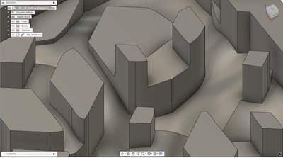

Hey Jodom4,
Have you tried doing it in a complicated 3D Model?  I tried using tapered with this shape and its taking way to long and scale function doesn't work well with this. I find that the Scale is only good for Solid Components. Are there any other way I can do a tapered side with this type of plane?
