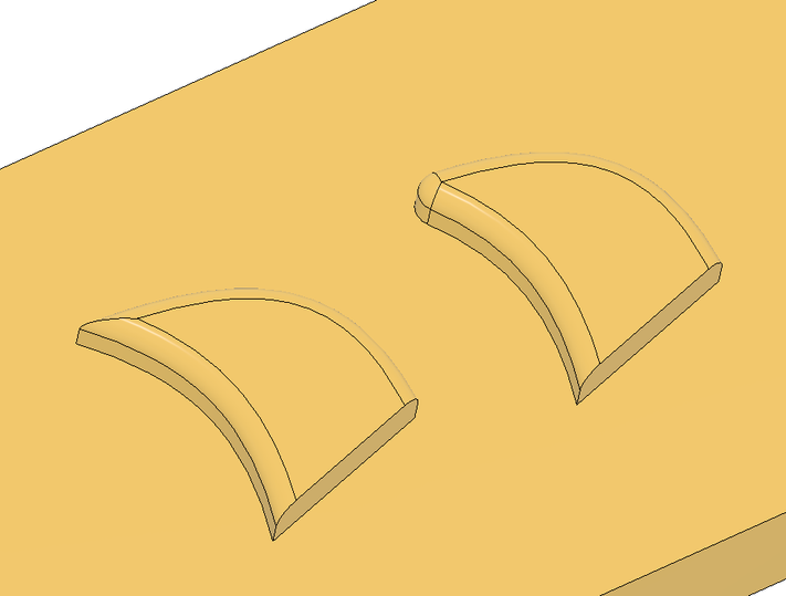

Total newbie to Fusion 360. I'm playing around with a coaster design, and have gotten it mainly done. I imported an svg graphic to the middle of it, extruded it, and started filleting the lines. For some reason I can't figure out, some of the corners come out pointed (how I want them) others have a rolled point. Is there an easy way to decide which you want?  I've searched the forums, but haven't found a precise answer. Any and all help deeply appreciated.

It looks like he rounded tips had the edge at the tip selected for the fillet, and the pointy ones didn't.
before fillet-
edges selected-
result-
Looks like that was it. Thanks! I don't remember selecting the vertical but, if I delete the fillet and redo it making sure the vertical line isn't selected it does it correctly.
