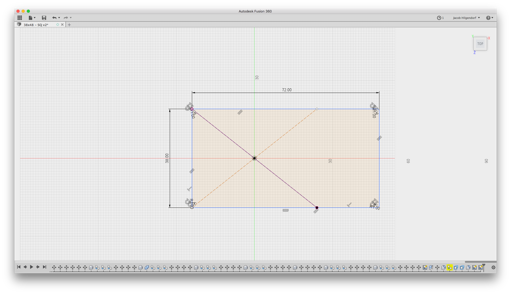

I am using Fusion 360 to draw table tops for a project I am working on. The table top I am currently working on has 1" radius corners on it. I have several 1" radius table tops to draw in various sizes. In the example image below I have drawn a 38"x48" top with the corners rounded centered on the middle axis point. I would like to then be able to change the dimensions of the top and have the sketch stay centered on the middle point. But currently, when I change the width the sketch scales out to the right like in the second image. Is there a way to keep the sketch centered and scale out from the middle?

You just need more constraints.
using a Centre point rectangle, fillet the corners, then add coincident constraints, between the rectangle sides and the end points of the diagonal lines, (8 constraints to add)
Dimension to either the rectangle sides or the diagonal points will then work.

davebYYPCU
Sorry, but the midpoint constraint creates unexpected results,
(snaps the first side being used to the origin)
Adding a point to the midpoint of the rectangle lines,
and then horizontal / vertical works with the point on the line.
Might help...

@jeff_strater:  This looks like a bug.  When a center based rectangle has radiused corners, the original center constraints are not honored.  Also, if you add a midpoint constraint to one of the rectangle's diagonal construction lines, the midpoint constraint is not honored when changing the length of a side.

Yes, this is a bug, you are correct.  The bug is FUS-29173

The best workaround would be to apply the fillets to the corners after extruding the 3d model.  If you use a User parameter, it will be easy to change the radius for different sizes.  You can also use a formula in the parameter to make the radius relative to the length of a side.
