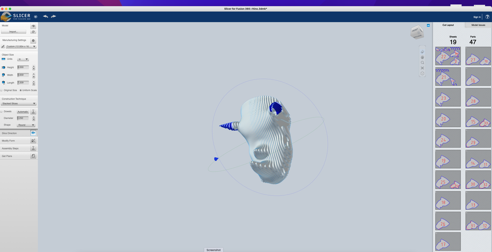

You say Slicer Add-in? The Slicer for Fusion 360 I use is a standalone program and although unsupported still works "as well" as it ever has.

Warmingup1953
Message 24 of 32
Warmingup1953

Message 31 of 32
Warmingup1953
Can you share the files?....I'll have a play with them in my instal of Slicer
