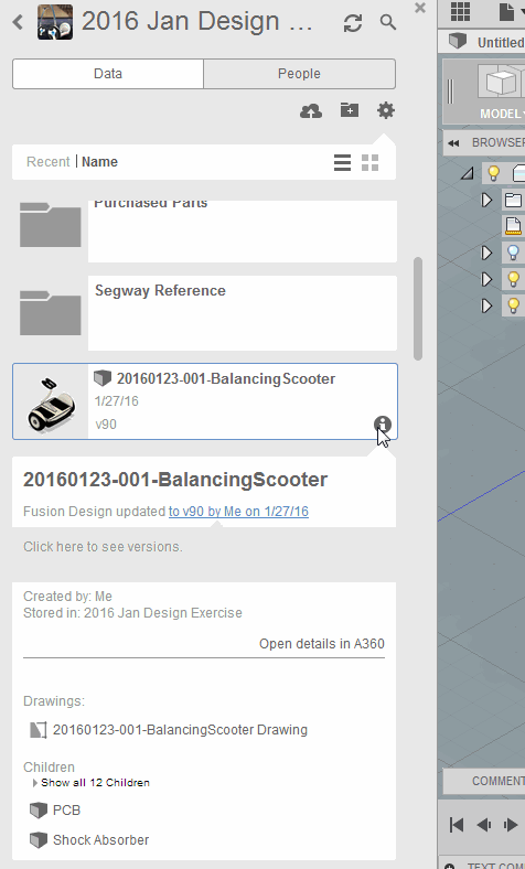

Hi Zephyr958,
Thanks for reaching out to us. It sounds you want to review the previous version and promote it if necessary. We have added the design history related functionalities in the Data Panel. (Please refer to the gif below for details.
We can also access it from the new UI of A360, but my favorite is from the Data Panel.
Regards,
Nicolas Xu
