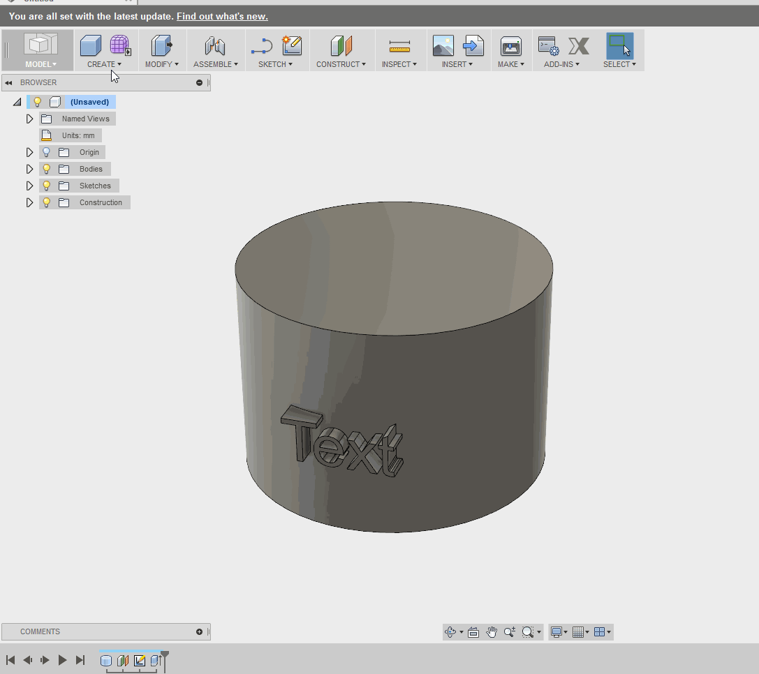

I have a cylinder with text on the surface of the cylinder that is extruded so the letters all reach the cylinder surface.  This creates a body for each letter.  Then I try and combine (join) all the bodies into one body.  However, it doesn't work.

No, it doesn't work.  I've tried it 10 different times now.  I can easily create a demo project for it because the problem is 100% reproducible.  Attached is a screen shot of before and after.  I've created a fake project that demonstrates the problem before and after.

Your example is NOT what I said as steps to reproduce! I want to combine all the letters.  I do NOT want to combine the letters to the cylinder yet.  I need to be able to do a circular pattern around the object FIRST, then I will combine the letters to the cylinder. If I do that without combining them, I literally end up with 500 bodies.  I want to combine all the letters as "ONE" body so when I do a circular body I just have 4 or 5 replicate letter groupings.

You can't combine seperate objects into one as far as I know, easy fix is to create a small rectangle box at the base of all letters and combine them to that, do your pattern and combine to the cylinder.
But a simpler solution IMO would be to combine them to the cylinder then do a circular pattern on the text feature so you don't end up with a bunch of bodies.

Combine only works on intersecting bodies, your letter don't touch so it will not work. Something you could do is make a rectangular body at the bottom of the text and combine that with the text. Something like this.

Maybe this is another way?  just a feature pattern of what @NicolasXu did.

That is very nice.  I see what you did there.  It is a lot of work to wrap text....lol   The rectangle box of material under the letters is starting to grow on me.  These have to double as "finger grips" and that might actually work better.
Also, TMC Engineering's solution looks like it will work when I did it on a test project for doing the circular pattern which I was unable to do once the join happened before.
