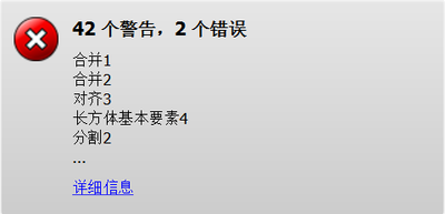

Are there any unresolved issues highlighted in yellow or red on your Timeline?
Does Ctrl b (CMD b on Mac) return a list of warnings and errors?

3088183712
Message 12 of 19
3088183712
Sorry, I thought you meant whether there was a blue line on the entity. I'm sorry
Message 13 of 19
3088183712
Message 14 of 19
3088183712
Message 15 of 19
3088183712
Thank you. I have found a way now

johnsonshiue
Hi! Split19 is the feature splitting the faces. You may just suppress or delete it.
Many thanks!

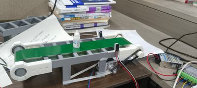

3088183712
 A support for a conveyor belt, which I use to complete my small electronic project
