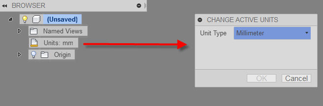

I design a body in Imperial units, then export the body as STL for 3D printing. When I open the stl file in Makerware, it invariably thinks the stl is dimensioned in mm, rather than inches. This requires that I rescale mm->inches in Makerware. It's just an inconvenience, but I'd like to fix it.
Is there something I need to do to make F360 export to stl files that have the same units that the body was designed in? Thank you.

The STL format does not support units.  It just records the X,Y, Z positions of the vertices for each face.  So if you are working in inches in Fusion and create the STL from within the application (as opposed to exporting from the dashboard) the positions are measured in inches.  When you take them to Makerware they are applying the X, Y, Z positions as though they were millimeters.
This is one reason we ask you what units you want to apply when you insert a mesh into Fusion.  If you had created the mesh in another application in another unit we will convert when you insert.  Makerware apparently doesn't support this?
I tried a test and I think there is a workaround you can apply prior to saving the STL file.  You can change the units of the document prior to saving the STL and then change back again.  I don't like this solution in general because it means you do have to remember to change back again after saving the STL.  After I changed the units and "Save as STL", the stl was created in millimeters.  I then needed to change my document units back to inches.
We could consider putting a conversion in the STL file if there is a strong demand for that.  Please post a request on the Idea Station if you want to have a conversion included.

@2herds If you modeled in inches just change the document units to mm then export and the STL will be in mm, just change back to inches after.
If you setup to export direct to your slicer the conversion is automatic as I think it's standard for slicers to work in mm.

This is a STEP format entry. Nothing to do with the STL format.
