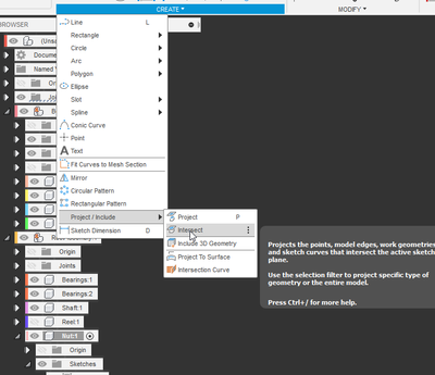

HughesTooling
The slice is only a visual helper, it doesn't actually slice the geometry. You need to use Project Interact to extract the intersecting geometry.

Great, thanks Mark, still "getting to know" the Project/Include tools. 🙂

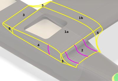

I'm trying to create a 2mm thick "fairing" body, over the top of two other bodies - the hull and cross beam of a catamaran. The background to this is probably better explained in another post, Create Fairing Between Two Bodies.
To recap from there:
My plan is as follows:
  1. Create a thin (2mm) body on the top of the curved cross beam. For this I made copies of the sketches with the 2 profiles used for lofting in that area, and cut away the parts of the curves I didn't need. Then I created a vertical 2mm face from the 2 resultant curves which I used for a Loft.
  2. Use the same technique forward of the beam on the hull to create a new face there, and then loft from the "beam body" to this new face, using some shaped rails.
  3. So the same on the aft side of the beam to the hull again.
  4. Side piece from beam to hull.
  5. Add in the missing fairing sections
I've managed to do Fairing Bodies 1a and 1b.  These were relatively simple, as the existing Beam Body they "cover" has convenient profiles from which the body was Lofted.
I made copies of those profiles in new sketches on the same planes, cut away the curve parts I didn't want, then used Sweep to provide new "surface" bodies - these gave me the profiles for a Loft. Here they are, moved up off the Beam Body:
Now I'm trying to do Fairing Body 2 as shown in my diagram.  To do that I need an accurate curve of the top of the Hull Body, from which I can do a sweep to create the 2mm thick profile, which I hope to then Loft with the edge of Fairing Body 1a.  With the help of a number of Rails.

Yep, your layout diagram makes sense.

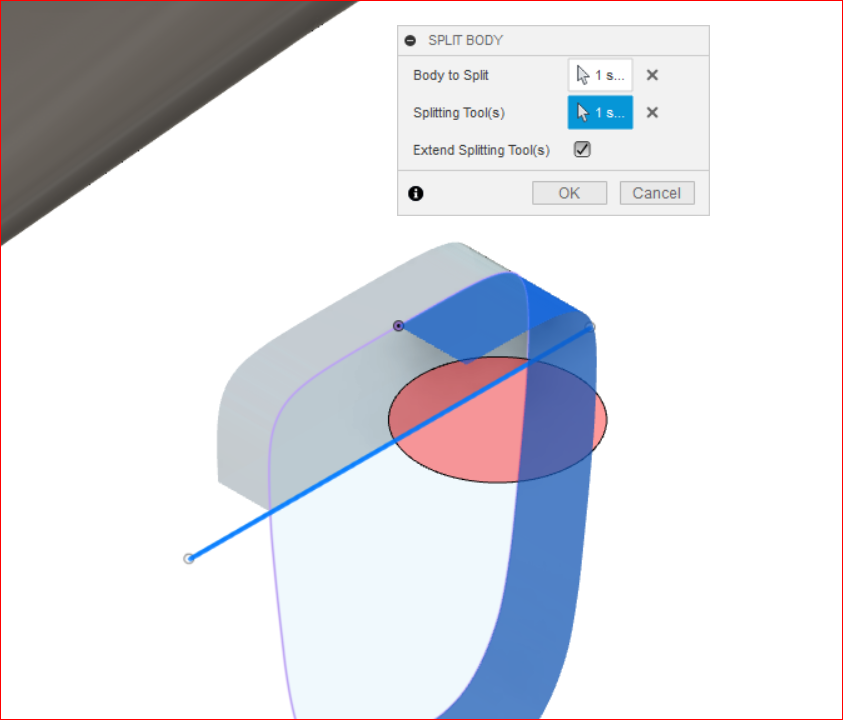

  1. Added a plane to intersect the hull, and a sketch on it = "Dave Hull Intersect"
  2. Project Intersected the hull
  3. Extruded one half of the project hull = Body 19
  4. Added the horizontal line, and Split Body = Body 20
  5. Tried to Trim Body 20, but the Trim tool won't enable the OK button to do this!
I've retried multiple times, still get stuck at the Trim.
Would you mind having a look at the file which I've attached please?

Not Trim after a Split body, just hide or remove.  My one side Extrude was for demo, you need the top bit of both hull profiles amongst other things, but there is a better way.
