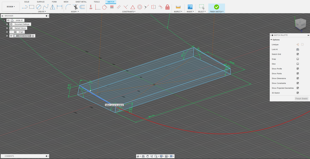

Hi! I don't understand why when I try to extend the arc it changes the placement of it. I tried to apply the coincident constraint to it before extending but that doesn't work, so the same is when I try to add the coincident constraint after extending the arc in order to align the points - it doesn't work.
Could you please say what constraint should be applied here or what I'm doing wrong? .f3d file attached. Thanks!

1. activate the design history.
2. I suspect that a 3-D sketch is not necessary, so I ask you what you want to achieve in the end.
Please show a real existing object.
günther

Here is .f3d file with history enabled. There is no real need in my sketch the arc to be extended as I described it in the topic. I'm just interested in why this generally happens.

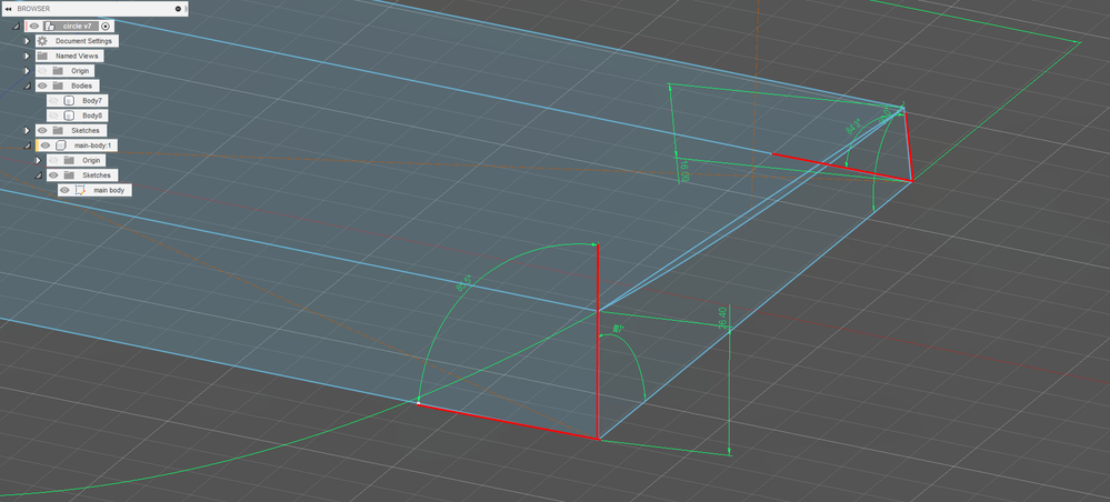

Look at the construction in the attached file.
When looking at the angles, you must of course pay attention to the plane in which they lie.
In your 3D sketch, the skeleton on the side does not result in a flat surface, but in a curvature.

But my sketch is all on the same plane and this still happens. Does an arc center point not get constrained to that point and if not, why not? What is the purpose of specifying the center of the arc if it can move unexpectedly and only discovered after many editing steps? Is there a history that can be edited in a sketch to correct this where it happens? Or can I specify that the center of an arc be constrained automatically? I can't count the number of times this has happened to me and in very complex sketches that need to be reconstructed, sometimes from the beginning. These points used to all be at the origin and when I try to move them back, they seem to have a mind of their own.

Image has limited information.
The black lines are already constrained somehow (unless they are dimensions), the white points are not, they will only go back to the origin, when the lines effected are permitting such a result.
Might help...
