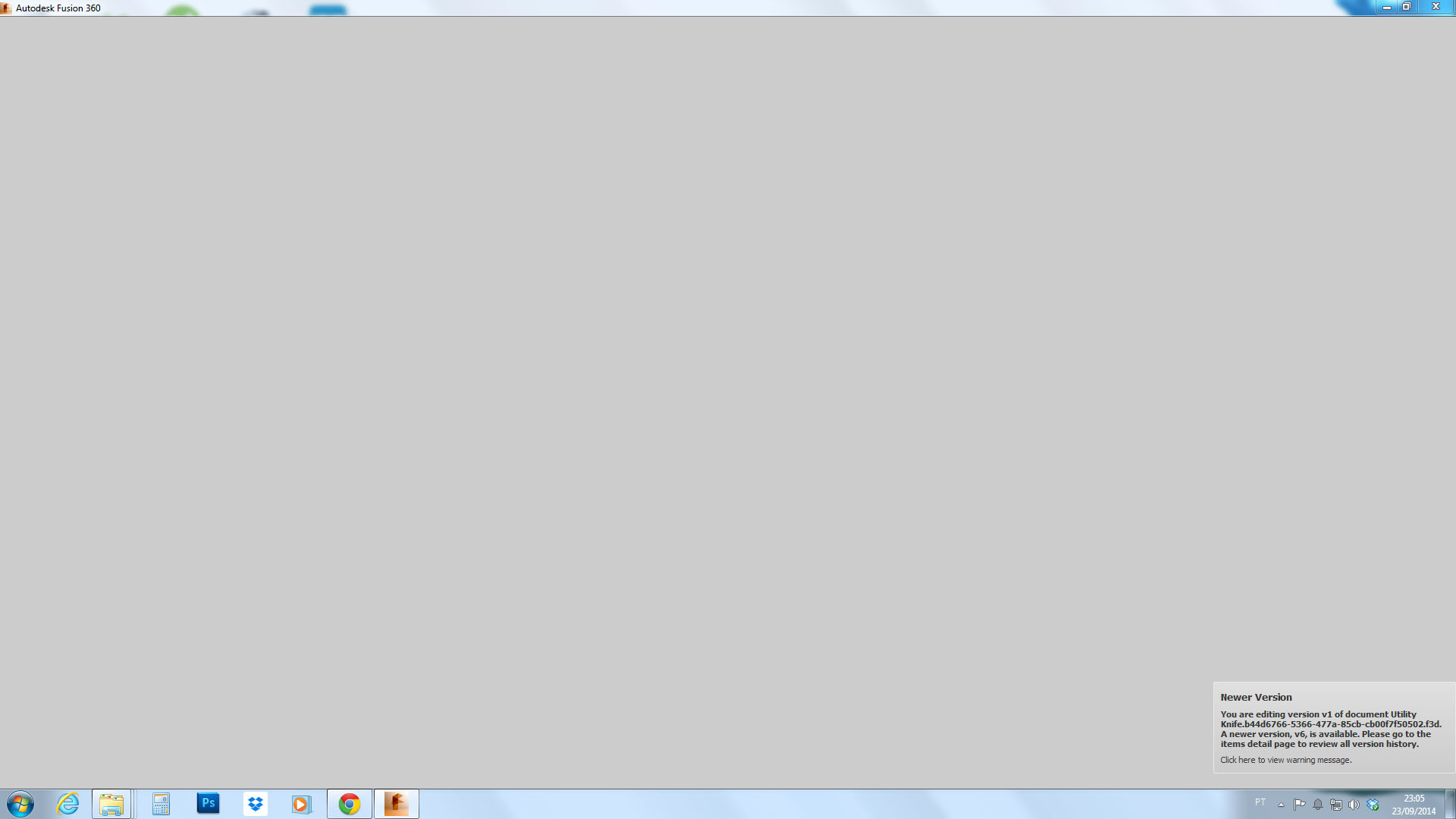

Hello everyone.
I'm in trouble when I open the Fusion.
Before it was working normally, but yesterday when I went to open it this error appears on the screen, I press OK and soon after the program crashes.
What can I do?
I've tried uninstalling and installing, I use a 64-bit win7.

I cannot find enough information from your log files to find the root cause out.
There would be a workaround you can have a try. Please delete the option file "NMachineSpecificOptions.xml" under "C:\Users\<User>\AppData\Roaming\Autodesk\Neutron Platform\Options" and launch Fusion 360 again.

Thanks a lot!!
Now the Fusion360 works fine!
