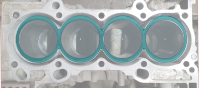

I have probably spent around 4+ hours messing with this an have redrawn it twice.
I need this specific spline to tangent to the circles given, and then be the same spline in all 12 places so that the profile is perfectly symetrical.
I have tried a variety of mirroring and trimming and not sure what else I could try.
I used a canvas to trace the spline closest to the center of the lens perspective. The other drawing dimensions are correct but the canvas can only be used on the spline I started because its closest to the camera lens centerpoint.
I have done this exact procedure at least 5 times in the past and though its usually a bit finicky I have never gotten stuck making it work for this long.
I need the whole profile to be a continuous selection with that exact spline repeated so that it can be offset
Any advice would be appreciated

Try using an ellipse instead of a spline:

Do you have physical measurements?  It may be parallax from the camera angle that makes it look elliptical.

TheCADWhisperer
@captaingamez
I am not sure that I understand the problem description.
Is something like the Attached what you are after?

That may be close to what I need. Im not extruding that final profile though. What we are doing is getting the existent profile of the wall of the cylinder jacket, then we mill that out offset about 0.025 on each side about .500 down. we then make a plate the same shape and press it into the cavity we milled. This creates a closed deck engine block which holds more power and the sleeves do not rick under load.

I tried doing an elipse and i trimmed everything and still cannot select a continuous line and offset it. I dont understand why this needs to be so difficult for almost no real reason.

You have end points which are not coincident as indicated by the white dots.  In this image, the left white dot is the arc center and the other is a non-coincident end point:
Tangent constraints are mostly missing.

Ok Disregard my previous comment, I realized what you were saying as soon as I opened up Fusion. I have a continuous line now after trimming the ends while zooming in to see the area that didnt trim correctly.
